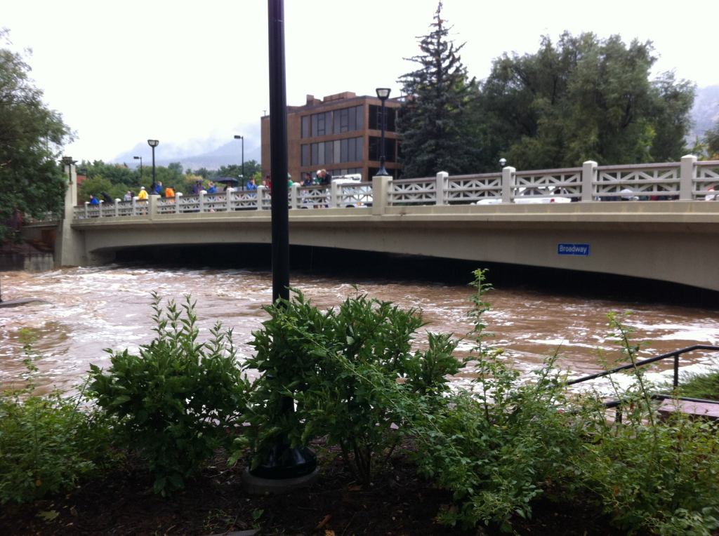

Boulder Creek rising under a bridge in downtown Boulder. Deep beneath the floodwaters are multiple lanes of bike and walking paths and a tall scenic waterfall.
Credit: K. Kermani
