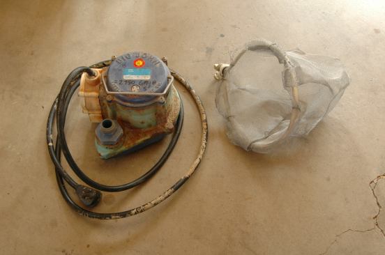

If you use a sump pump, create an external intake filter by setting it inside a 5-gallon bucket with lots of small holes drilled in it; even better, wrap the pump in a piece of screen or hardware cloth. I prefer the screen method because I can get the pump lower to the floor or even set it down into the floor drain opening at the lowest spot in the floor. These rudimentary filters may still need debris pulled away from them when clogged, but they will keep the pump's impeller clear and free from damage.

Many portable submersible sump pumps cycle on and off via a pressure switch, so they won't turn on until they are under several inches of water. This can be a problem once the water level goes down. I can sometimes activate mine by bumping the pump against the floor, but at some point it will stop with a few inches of water left standing.
Sump pumps with float switches are easier to rig manually because the external floats can be wired or taped into an "on" position, but be careful not to burn out the pump by running it dry. You may get down to as little as one inch of water with one of these pumps.

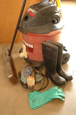

Regardless of the type of pump you use, you will be left with lots of water still on the floor. So for the next step, you can either bail the remaining water into a bucket with the pump in it, or switch to a wet vac.
Wet Vacs

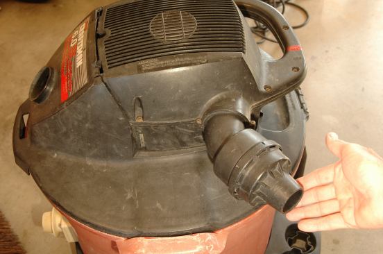

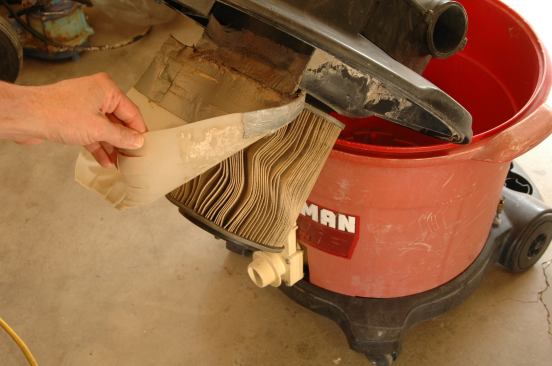

Wet vacs are very efficient for sucking up water and sludge, and the bigger the vac, the better. I leave all of my European skinny-hose vacs in the shop when it comes to this kind of work and rely on a big, inexpensive vac with a large diameter hose. It works fast, holds a lot of water, and the filter is relatively cheap to replace after extra dirty jobs like this. I know these vacs can be used with the filter off for wet use, but I prefer to leave it on to protect the motor from excess moisture and nasty contaminants.
For efficient wet vacuuming, use the shortest hose you have and avoid loops or low spots in the hose that will act as a trap. Prop a flat nozzle about 1/4-inch off the floor in a corner or at the lowest spot in the floor, and use a large push broom like a floor squeegee to direct the remaining water to the vac.
My vac has a float ball to block off the suction when the vac is full of liquid and you can tell when the ball seals because the motor sound changes to a high-pitched whine. Some of my fancier vacs shut of via an electric circuit that the water closes. Just be sure you know when your vac is full of water so you don't have to wait for a loud pop, a puff of smoke, and all the lights going out to find out.

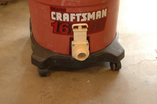

With my 16-gallon vac full of water, it weighs about 150 pounds so the easy way to empty it is to drop a pump into the tank for several seconds. On jobs without a pump present, fill the tank only partway and empty it into two five gallon buckets that you can carry up the stairs. When clearing a flooded crawlspace, I left the vacuum on the main floor above, rolled it to the doorway when full, and drained it into bucket through the vac's drain port.
