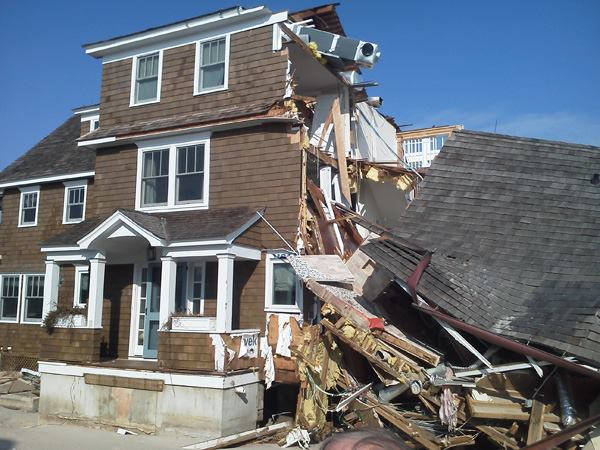

The intact addition shown above withstood Sandy's storm surge on the beach at Mantaloking, N.J. The original house was undermined by scouring and collapsed.

Borden finally gained access to Mantaloking over the weekend, where he took the photo below of another remodeler’s job, damaged by surge flooding. The back part of the house, an addition built to newer codes, is intact, while the original front portion was undermined, and collapsed. Says Borden, “The same wave action went all the way around the house. There was five feet of sand deposited on the back side of it. The original house had nothing tying it down to the sand, but the new back part was able to withstand the onslaught. It looks like a house in move-in condition.”
