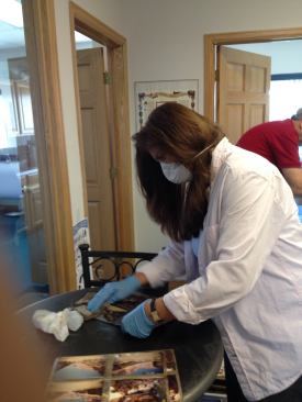

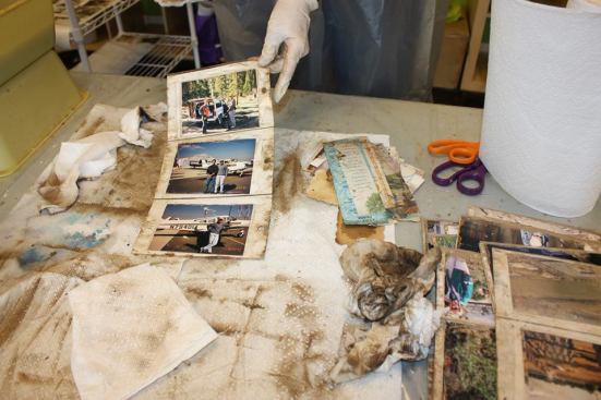

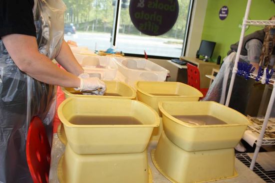

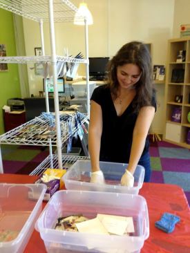

A soak and thorough rinse in tap water is the basic cleaning step for flooded papers and photos. Besides rescuing sentimental papers like your marriage certificate or college diploma, you probably have tax and legal documents that you must save and hold on to. Standard office paper falls apart easily when wet but can be dried and saved if you are very careful. Peeling apart wet pages that are stuck together may be easier with the stack of paper partially dry but you may have to experiment with this process. Individual sheets can be dried laid flat on screening or hanging vertically from clotheslines set up indoors (if the paper is dry enough to hang by clothespins without tearing the paper). Be sure to use plastic clothespins—wooden ones can hold moisture and mold spores.

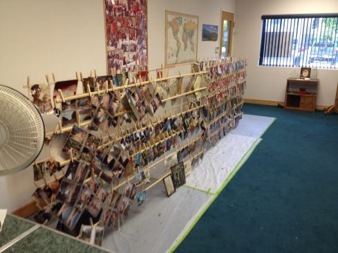

Photographs printed from negatives usually fare better in these processes since they were originally made in a wet process that included a water wash. Common, resin-coated paper prints (from commercial film processors) are more durable when wet and can be dried lying flat or hung up with one or two clothespins. Fiber-based photo paper (older black and white images and fine art prints) needs to handled more delicately when wet and will curl when it dries. Because of this, drying between two screens or hanging with clothespins on the bottom corners may be necessary to make the prints dry flat. Of course photographs can be reprinted if you have the negatives in good condition.

Papers and photos that have been contaminated by gray or black water flooding may contain e-coli and other infectious agents that you don’t want to store in your file cabinets and shoe boxes, so you have to decide if you want to try to preserve the originals or just clean them well enough to be duplicated and then discarded. A quick rinse should be sufficient for putting papers and photos on a photocopier or scanner, and this can be done before the items are fully dried which can save time.

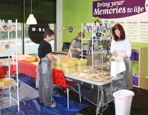

After the Colorado floods, a non-profit group known as the Memory Preservation Coalition set up four regional document and media rescue centers to give people a place to clean and process their damaged items free of charge for five weeks. These locations were manned by volunteers during the height of the clean up who helped affected residents rinse, dry and digitally scan all of the photos and papers as they needed to rescue. In addition, other forms of media such as tapes and films could be rinsed and dried at the sites. The rescue centers were set up in coalition member stores that offer digital media transfer services so if flood victims wanted to have their damaged media copied to new digital media, they could purchase those services at the same place.
The coalition also offers a service to help return photos found after a natural disaster with their owners who may have lost them in a flood, tornado, or hurricane. This effort started after Superstorm Sandy last year when volunteers picked up over 30,000 photos and posted them on a site to help reconnect them to families who assumed the photos were lost forever. http://memorypreservationcoalition.org/
