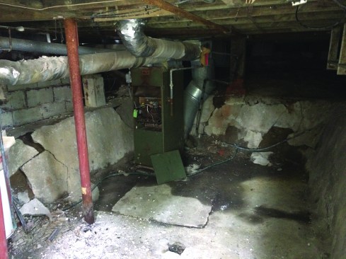

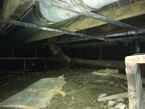

In March, I inspected the house with Scott Craven and conducted an energy audit. The tiny cellar with its 6-foot ceiling extended under only a quarter of the house. The rest had a low dirt crawlspace. The whole thing was surprisingly wet. Steel Lally columns were rusted through. The furnace and water heater had been red-tagged by the gas company as a hazard. The ductwork was literally being held together with Saran Wrap. A perfect gut opportunity!

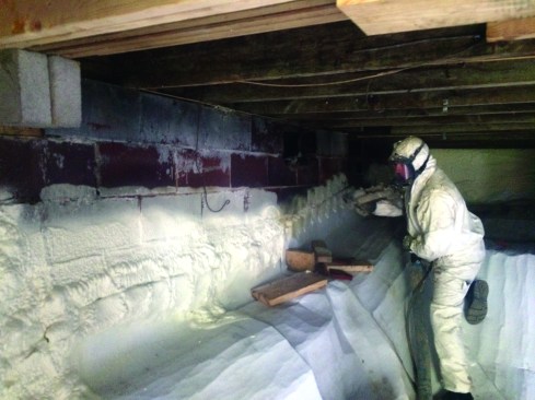

The dirt crawlspace created a huge moisture load for the interior.
Mechanicals in the basement were fully depreciated.
In his 2005 book, Water in Buildings, University of Illinois research architect Bill Rose noted that every home he has inspected with a dirt crawlspace had moisture problems in the attic. This house fit the pattern: The roof sheathing was moldy, and in some locations, rotten. Our plan would have to address the moisture issues.

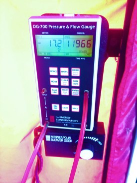

Next, we ran a blower-door test. This was one of the leakiest homes I’ve ever tested. As a rule of thumb, we’ve found that a blower-door number roughly equal to square footage gives us enough control to solve client problems (that is, a 1:1 ratio of leakage to square footage). This house is only 720 square feet and its blower-door result was a whopping 12,000 cubic feet per minute at 50 pascals (cfm50)—a 16:1 ratio. To be fair, the house was completely gutted, so the real ratio was likely closer to 4:1. Still, a house that leaky is a major challenge.
Moisture and energy issues were a big challenge. The home’s measured air leakage was off the charts.

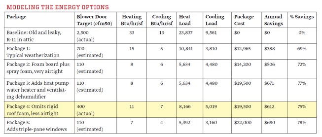

We have developed what we call a “comprehensive planning process” that helps break complex problems down into small bites. Beginning with a baseline energy audit, we apply iterative energy modeling to help develop the best path to success, given client problems, objectives, and budget.
My initial thought was to tackle the house with traditional weatherization tactics: Air-seal the attic, dense-pack the walls with cellulose, and put a vapor barrier down in the basement. But the likelihood of a good leakage result with this approach was low, and it failed to address the existing attic moisture problems. We needed to dig deeper. We turned to iterative energy modeling, using TREAT energy-audit software from Performance Systems Development (psdconsulting.com). (TREAT stands for Targeted Retrofit Energy Analysis Tool.)
Click for enlarged version.
TREAT modeling software, which the author trusts based on past experience, created savings projections for several retrofit proposals. Based on costs and benefits, the author chose Package 4. The model had assumed very low air leakage (110 cfm50), but the actual Package 4 airtightness (400 cfm50) still resulted in a major improvement over the baseline.

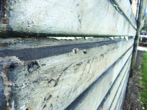

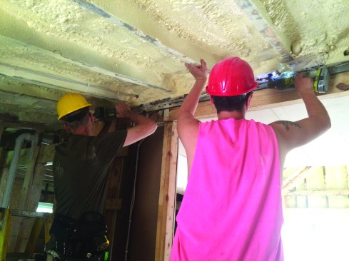

As we modeled various pathways, a thorough air-sealing of the whole enclosure emerged as the best option. In this case, that meant spray foam. It would cover the moisture problems and encapsulate them, thus eliminating a remediation problem we didn’t have a budget for, and at the same time, would solve the Swiss-cheese leakage problem. As long as we were sure to consistently dry the building before sealing it up, moisture issues should remain licked. Spray foam also provided 72% greater modeled energy savings compared with the standard weatherization package and allowed us to confidently use very small heating equipment. Finally, spray foam made the project drywall-ready quickly—a volunteer drywall party was breathing down our necks.
Foam quickly addressed major air leaks like the big gaps between pieces of the existing board sheathing.

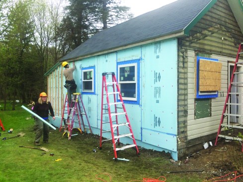

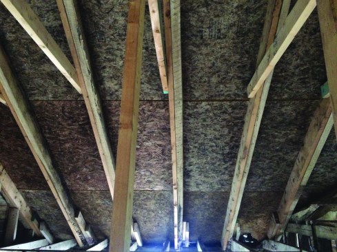

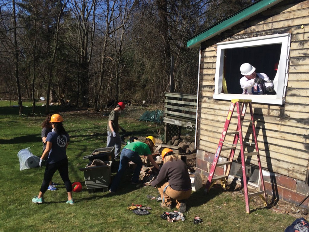

Our initial design would have treated the roof and walls the same: 1 to 2 inches of spray foam inside (primarily for the air-sealing benefit), with rigid foam outside for the insulation benefit. The rigid foam was donated by Dow and would be installed with volunteer labor. Our final implemented package increased the roof-deck spray foam and deleted the exterior foam on the roof. The additional spray foam cost more, but this approach avoided the complexity and time of applying foam board to the roof.
Volunteers added donated rigid XPS insulation sheets to the exterior to augment the R-value of the wall system.

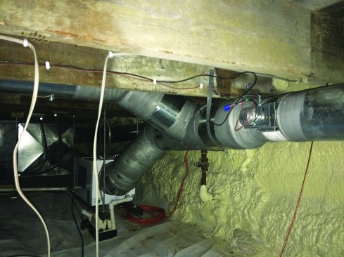

Spray foam in the basement cut the heat loss to the ground, as well as limiting the building’s vapor load. A foam application sealed the ground vapor barrier to the wall.

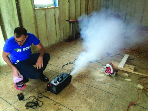

The spray foam was not as effective an air-sealing solution as I had hoped. But after the foam was completed and we put a cover on the basement door in the rear, the house was at about 1,500 cfm50. At that point, we did additional air-sealing with a one-part gun foam. I depressurized the house and looked for misses and low spots. That brought it down to about 1,000. Then, I used theatrical smoke and pressurized the house, observing where the fog blew out. The Habitat volunteers helped find the leak points, and I sealed them one by one.
A fog machine helped to identify remaining air leaks for point-sealing with one-part gun foam.
After two rounds of touch-up air-sealing, we got the house down to 440 cfm50 before drywall. My very optimistic target of 110 cfm50 was not likely to happen. I was disappointed about that, but it was still an excellent result: This may be the tightest house in the county. These numbers also imply that the 700 cfm50 target for the non-foam weatherization package was wildly optimistic: I would have been lucky to get this house close to 1,000 cfm50 using traditional methods. Spray foam put this home’s heating and cooling load well within range of our chosen HVAC solution.

In a house this tight that also had previous moisture problems, we wanted to be sure that it would have sufficient dehumidification in both heating and cooling seasons. Our usual choice for managing fresh air and humidity is a ventilating dehumidifier—a device that brings in fresh air to the duct system and dehumidifies as needed, any time of year. It then distributes the air throughout the home using the duct system. (For this project, the unit was kindly donated by Ken Gehring and Thermastor.)
Combined with a media filter on a central duct system, the ventilating dehumidifier lets us control humidity and particulate matter (PM2.5). Research indicates that by controlling humidity, we help to control volatile organic compounds (VOCs), as well (see, for example, Dr. Richard Corsi’s work at the University of Texas). The home should have excellent indoor air quality (IAQ) by design.
In the past year or so, we have begun monitoring some of our project homes using Foobot IAQ monitors. We have noticed that VOC levels spike along with humidity—confirmation of how important good dehumidification is to comfort and IAQ.
With this fresh-air supply technique, the temperature of incoming air can be a comfort problem. Because we lost some of the tempering capability of an HRV/ERV, we ran extra-long uninsulated duct through the basement to help temper the incoming air.
The author’s preferred HVAC solution for high-performance homes is a central heat-pump system, coupled to a fresh-air intake and dehumidifier. A long fresh-air-intake duct in the unconditioned basement helps to temper the incoming air for comfort. Dampers open and close the air intake in response to temperature conditions and prevent unwanted backflow through the dehumidifier.
Shown above is the ventilating dehumidifier in the basement. On the right is a 35-foot-long intake line. Nearby is the motorized damper to open and close the intake at high and low temperatures. The “T” allows fresh air to go directly into the HVAC system and bypass the dehumidifier when dehumidification is not required. We have dampers everywhere so that we can easily adjust and balance the system during commissioning. There is also a backflow damper between the dehumidifier and the air handler so that air can’t short-circuit through the dehumidifier when it’s not operating.

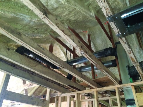

Because the roof was insulated, some ducts could also be routed through the attic.
Our TREAT calculations estimated a heating load of 8,166 Btu/hour at 5°F for the insulating and air-sealing package we installed. We trusted that estimate because we’ve tracked actual system runtimes on other homes, using Ecobee thermostats, and we’ve established that TREAT provides reasonably close projections (typically within 10% or 20% of actual performance).
By comparison, the industry standard Manual J, which contains a variety of “fudge factors” in order to prevent undersized systems, seems to overstate the load by 50% or 60%, particularly in high-performance homes.

Volunteers also did extensive work creating the home's new energy-efficient exterior.
