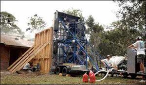

Most visible was a “Wall of Wind” machine. Described by one researcher as the “mother of all airboats,” the business end of the trailer-mounted rig was equipped with two caged airboat propellers, each driven by Chevrolet V8 502 motors. Built at Florida International University and completed this spring, the machine can generate 120-mph winds. Combined with “rain” sprayed in from a 500-gallon tank, the end product approximates a Category 3 hurricane in a space the size of a car.
“It’s not designed to blow down a house,” explains Kurt Gurley, an associate professor of civil and coastal engineering at the University of Florida. “It’s designed to test the components of the house that are having performance issues.”
Shingles and tar paper fly off of the roof of a vacant home in central Florida as a custom-built wind machine pounds it with hurricane-force winds. Part of a University of Florida-led hurricane research project, the experiment was one of several aimed at learning more about how hurricanes damage homes that were built before Florida adopted its first statewide building code in 1994.
