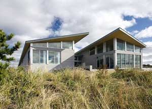

This net zero-energy custom beach home in Truro, Mass., was completed in 2008. Facing west across the Cape Cod Bay, it incorporates solar panels and geothermal heat pumps to produce more power than it consumes on an annual basis. Carbon-based energy consumption is limited to propane cooking equipment. For more information, see the ZeroEnergy Design website. Photo Credit: Eric Roth Emile Chin-Dickey is a principal with ZeroEnergy Design, an architecture and energy consulting firm based in Charlestown, Mass. Like much of his company’s professional team, Chin-Dickey was a member of Cornell University’s “Solar Decathlon” team in 2005. After earning college and advanced degrees, several team members stayed together to found an architectural firm with a focus on maximum energy-efficient design and construction. Says Chin-Dickey, “Our working and professional relationships extend back to the very beginning of the Cornell project. We had a chance to conduct a lot of research, and also to get a feel for how the working relationship and the design process should work. And it was through that trial and error that we were able to develop the business model and the design process that we have today, and to bring that to the market after the competition ended.” Now that the team has gone pro, says Chin-Dickey, “We staff architects and consulting engineers, and we can do custom residential design, as well as the mechanical and energy design. For our custom projects, we do both the architectural design and the mechanical and energy design. But for some clients who already have a design, or builders or developers who just want to make their building more efficient, we will provide just the energy design service — run an energy model and give them an idea of which are the most cost-effective building improvements.”
