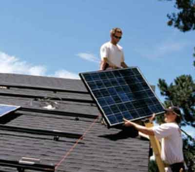

Solar modules can be installed on nearly any type and pitch of roof. They are usually attached to racks — metal rails supported a few inches above the roof’s surface by mounts that are bolted to the rafters.
New construction and reroofs. It’s easiest to install mounts on new construction or on a roof that has been stripped; this way, we can fasten them without having to worry about leaks. On these jobs, we put post mounts on the sheathing and lag them to the rafters. We then flash the posts with the same flashings used on plumbing vents. This obviously produces more penetrations than usual, but the roofer should be able to warranty his work, because everything is properly flashed.
Tile. On tile roofs, we use an aluminum mounting channel called a Tile Trac (Professional Solar Products, 800/847-6527, www.prosolar.com). The channel bolts to the deck and a threaded post extends up and passes through a 3/8-inch hole in one of the tiles. This penetration is caulked and, because it’s high on the tile and covered by a module, it doesn’t leak.
Existing roofs. Retrofits are trickier. On tile roofs, tiles must be removed and reinstalled over the mounts. On flat roofs, some of the membrane must be removed and patched back in.
We install many systems over existing composition shingle roofs. The preferred method is to fasten mounts through the shingles. Tile Trac works well for this application. It comes in 8-inch sections, which we install up the slope on a thick bed of sealant. We’ve put a lot of effort into finding appropriate products for this application and have settled on tripolymer sealants like Geocel 2300 (Geocel Corp., 800/348-7615, www.geocelusa.com) because they are durable, adhere well, and are compatible with asphalt shingles. As an added precaution, we divert water from the penetration by installing a piece of step flashing just upslope.
On retrofits, it’s important to avoid drilling unnecessary holes through the roof. It’s easy to locate rafters when the tails are exposed, but when they aren’t, we go into the attic and drill a pilot hole next to the rafter where the first mount will be located. We leave the bit sticking up and locate other mounts by measuring off it. Rafters may not be evenly spaced, so we always check the layout from inside.
Loads. The local building department will want to know how much load the solar array adds to the roof. It’s typically 4 pounds per square foot. We’ve had some success convincing concerned inspectors and engineers that the added load on the existing structure is okay because no one can walk on an area that’s covered with modules. Also, it doesn’t snow in our part of the country, so offsetting the local requirement for 20 pounds of live load with 4 pounds of dead load is usually a no-brainer.
Hardware. Our systems are designed to last 30 years, so it’s important to use hardware that will not corrode or react. All of the components on the roof are made from aluminum or stainless steel, including the lags that secure mounts to the roof, and the nuts, bolts, and washers that hold the other parts together. We’ve come across corrosion problems that occurred when competitors combined aluminum, copper, and galvanized steel in the same installation.
