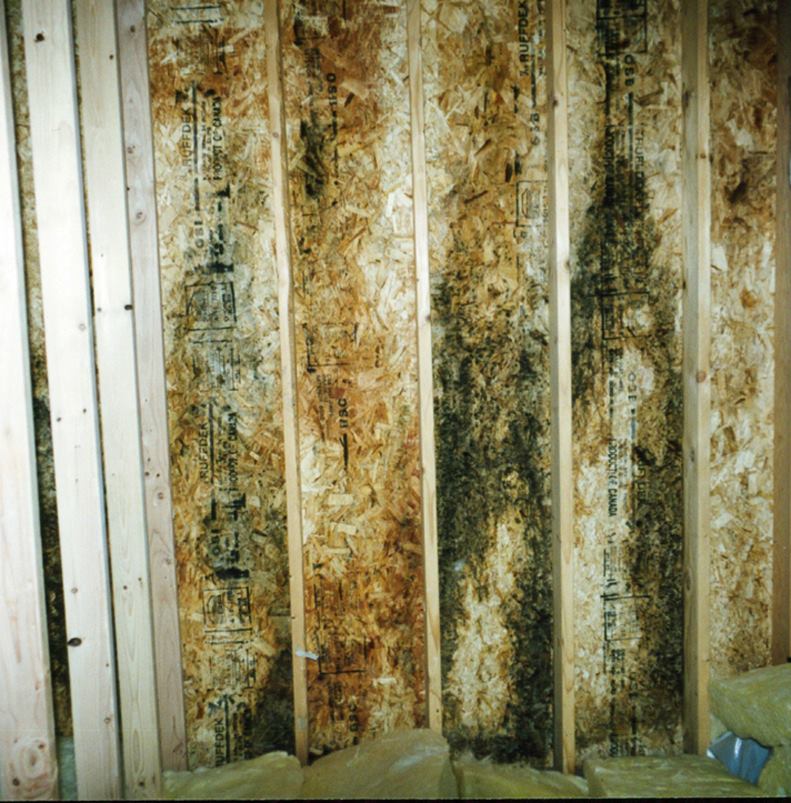

In most homes, air leakage is the biggest driver of moist air into wall cavities. But in the case of a thin wall without a vapor retarder in a cold climate, high indoor humidity can diffuse through the interior finish and condense on the cold surface of the exterior sheathing.
Credit: Steve Easley

Diffusion is moisture-vapor movement through building materials. The driver of diffusion is vapor pressure, which can be understood loosely as the weight of the moisture in air. Humid air has a high vapor pressure and wants to move from the humid side of a material to the drier side. Like any pressure, vapor pressure wants to equalize; the drier air in the wall cavity is pulling the more humid air to it. (Or is it the wetter air is pushing out?) I think of the air in a room in winter laden with water. Forgetting about air movement in the room for a moment, think about the moisture as uniformly distributed through the air in the room and “soaking,” so to speak, into the drywall. As if pulled by the drier air, it moves through the microscopic interstices of the wall materials into the wall cavity, floats through all the air pockets in the cavity insulation and, if the back side of the exterior sheathing is below the dew point, will condense on that surface. This can lead to the mold seen in the top photo on this page. Of course, you need to have really high humidity in the room and dry, cold air outside for this to be a significant problem.
Diffusion is not a big deal unless you have humid conditions and a big difference in temperature. We’ve all seen these conditions: tiny houses with three teenagers taking two showers a day. Hundreds of house plants. Cords of firewood drying in the basement. Indoor pools. Nate Adams’ “Petri Dish House” (Dec/14) is a great example of conditions that are ripe for significant diffusion problems. But in truth, most of the time diffusion is not a big a deal, except when you use super-low-perm materials like poly and foil.
