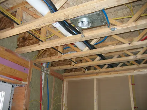

My setup was different. In order to get the best distribution for heating and cooling, I located the head on an interior wall. This presented two challenges: First, the 50-foot line set would run above the first-floor ceiling before exiting the house. Second, the condensate line would run independent of the line set and tie into the plumbing waste line, which would have to be trapped to keep sewer gases from escaping into the house.

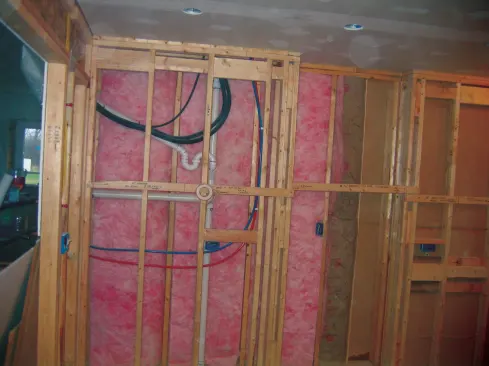

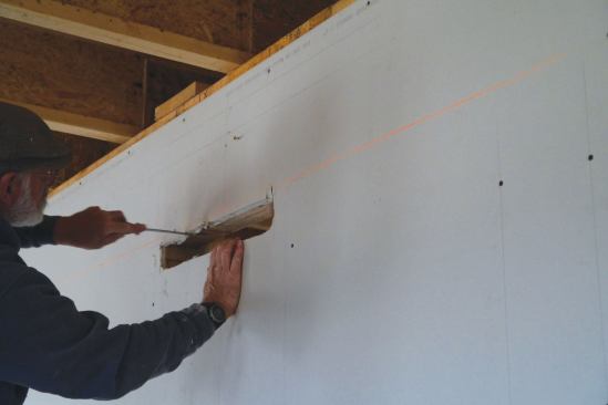

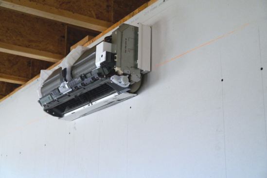

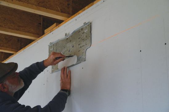

The interior head of the minisplit hangs on a metal plate attached to the wall, but the line-set connections have to be made to two copper stubs attached to the head. For an indoor head hung on an outside wall, the stubs are long enough to pass through the wall and bend downwards before connecting to the line set. First you hang the wall unit, and then make the connections.
For my installation, however, the stub-to-line-set connections would need to be made before hanging the wall unit. This required two people—one to hold up the unit, one to make the flared connections. Fortunately, I’d framed a 16-inch-wide chase, built of two parallel 2×4 walls. It was intended to hide ERV ductwork and DWV pipes, but would also allow me to hang the wall head, poke the connected stubs through a partition wall, and make the rest of my connections with the head securely mounted to the wall. I left 2 feet slack in the line set so that if the unit needs to be removed for service or replacement, there will be no strain on or kinking of the copper tubing.
To achieve this, I broke away the knockout in the hanging plate. This allowed me to run the tubing stubs through the partition wall. I had already blocked between the studs for mounting-plate support and hung the drywall.

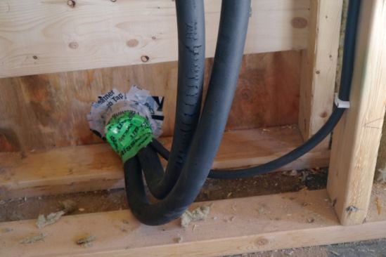

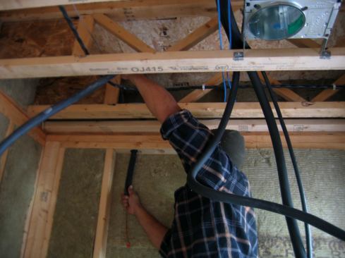

The 50-foot generic line set includes one ¼-inch flexible copper tubing and one 3/8-inch flexible copper tubing, both wrapped in 3/8-inch foam insulation. Without going into the physics of vaporizing and liquefying the refrigerant, the smaller tubing handles high-pressure liquid and the larger tubing carries low-pressure vapor. A helper and I snaked the pair through an open joist floor system to an outside wall, then bent the tubing downward before bending it again to exit the wall. We were careful not to kink the tubing. When the wrapped tubing dragged against framing members, the foam insulation easily tore; we used duct tape to make repairs.
Running in tandem with the line set is a 4-conductor wire that powers the indoor head from the outdoor compressor and allows communication between the two. I used zip ties to bundle together the tubing and wire. Where the tubing and wire passed through the wall sheathing, I sealed the wall penetration with Siga’s (siga.ch/en) impermeable, highly elastic Rissan tape.
Mitsubishi instructions call for the stubs to be insulated and wrapped with tape prior to commissioning the system. The tech that commissioned the system completed this.

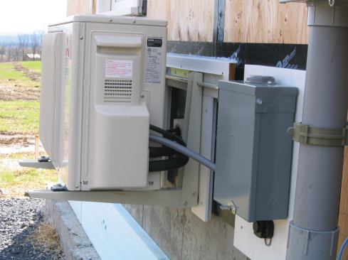

Several considerations need to be taken into account when locating the outdoor compressor. Aesthetics is the first: Although the compressors are not unattractive, clients will not want one sitting in their front yard.
The next consideration is protection. It’s a good idea to locate the compressor on a gable end, safe from roof snow slides. If you must place it under eaves, consider a canopy roof above it for protection against falling snow and ice.
Finally, there’s a choice between placing the unit on the ground or hanging it off the wall aboveground. In snowy climates, I recommend the latter. Two feet above grade will reduce the chances of the compressor being covered with snow that interferes with its operation. If you decide to place the compressor on the ground, locate it away from a wet area and fasten it to 6×6 pressure-treated “logs” to keep it off the ground. Rubber and fiberglass risers are manufactured by Big Foot systems (bigfootsystems.com) and DiversiTech (diversitech.com).
I hung my compressor on a gable end and used a bracket kit from Rectorseal (rectorseal.com). Because the compressors would be hung before the siding, I trimmed behind the brackets with 5/4 pine. I also used a through-wall sleeve (goductless.com) to tidy up the line-set wall penetration.

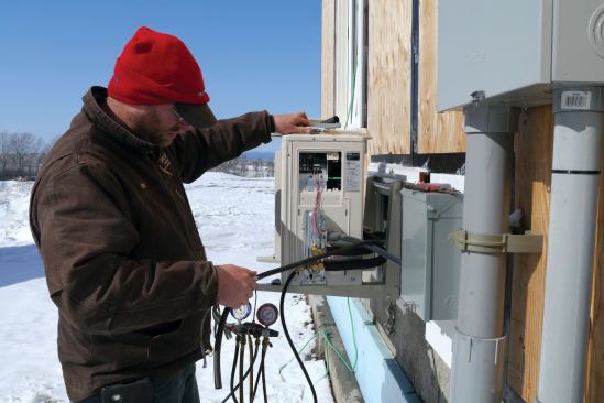

Typically, the condensate drain line exits the building with the line set and water trickles out when the minisplit is in air conditioning mode. (In winter, any condensate created is at the outside compressor, and it, too, empties to the ground.) Because my indoor head was located on an interior wall, I had to find another way to remove the condensate. I already had a 2-inch drain line in the 16-inch chase, so I tapped into that, installing a P-trap to keep sewer gases from entering the house.
The National Electric Code requires that minisplits have their own sub-panel and that an outlet be within 25 feet of the sub-panel. Mine was sized (220V with two 20A circuits) to handle both compressors.

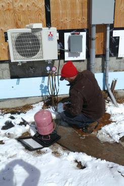

After mounting the major components, I called in a licensed refrigeration technician—required by code—to make the connections between the indoor head and line set and the outdoor compressor and line set, evacuate the lines, check the refrigerant level, and test-run the AC and heating operations. In my rural area, local qualified techs are hard to find, but my wholesaler knew a tech willing to travel and just do the commissioning, even though I hadn’t purchased the equipment from him.
