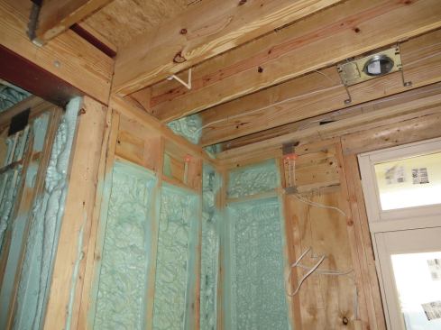

We use our IR camera mostly to find and fix air leaks and insulation flaws. It’s particularly helpful as a quality check for spray-foam work. Our experience is that even the best crews accidentally leave voids. The thermal camera shows these quickly and clearly, and when the crews can see the issue with their own eyes, they don’t feel we’re being overly strict when we ask them to fix the gaps.

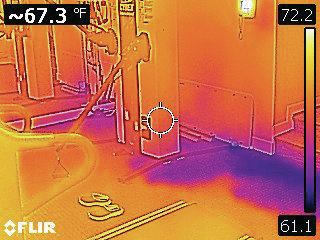

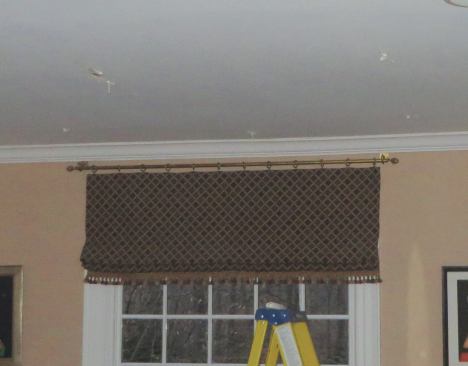

Leaks and moisture. A thermal camera is also good for leak investigations. Most porous materials are cooler when wet (because the water evaporating from the surface cools it), and the camera can “see” what areas have been affected by a leak from all the way across a room, as shown in these photos of a ceiling below a bath leak. The wet areas appear as “cold” spots. It’s not that you couldn’t figure it out with a moisture meter or by cutting open the finishes, but with the thermal camera you can quickly evaluate the entire affected area of drywall or flooring. You can take photos, which help clients and insurance companies understand the scope of work, and you can start at the source of the problem rather than having to trace it from the area first found to be wet.

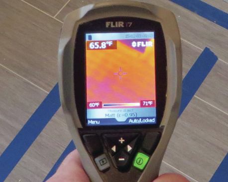

In-floor heating. We use an IR camera on heated floors, too. Besides using it for ordinary problem solving (for example, to determine which loop is which on an 8-loop header), we often use it when we need to return to a job. In our custom construction business, we need to drill a hole or install a floor-mounted door bumper in the middle of a heated floor a couple of times a year. With the thermal camera, we can see exactly where tubing or electric heat wires are located. Even when they are 1 1/2 inches apart, we can confidently locate where to put the door stop or the mounting point for a frosted glass panel. One trick we’ve learned is to put masking tape on the floor in the area in question and mark that with pencil. If you warm up the pencil in your hand for 10 seconds, it will show up nice and bright on the camera screen and you can verify you are marking right on top of the warm wire in the floor.

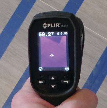

The TG-165 is a solid performer at the tasks it’s designed for. It’s a compact, solid tool that feels like it would hold up fine in a tool bag. It’s designed primarily for electricians, HVAC techs, and facility managers as an alternative to a pistol-grip spot thermometer. At $400, it’s roughly twice the cost of a top-of-the-line Fluke or Klein spot thermometer. But in addition to measuring temperature, this tool can provide an infrared image of the whole area around the spot you’re aiming at—useful information that will help in verifying electrical installations and diagnosing mechanical problems. For a general contractor, though, it lacks key features that make an IR camera such a worthwhile investment.
In particular, the smallish screen has a low resolution (60×80) that does not show much detail. You can find hot and cold spots in walls, ceilings, and floors, as long as you move around and approach the spot to get an accurate gauge of temperature differences—but the saved images are hard to read and not very useful in reports or emails.
I also found the autoranging feature especially frustrating. The TG165 seems to re-range frequently, and the colors constantly cycle back and forth. When I used the tool to search for warm floor heat wires, for example, I couldn’t confidently see the wires . The tool showed the whole floor at the same color. My old i7 was able to range correctly to show the heat wires in a different color from the rest of the floor.
