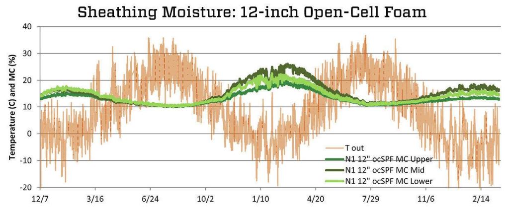

Ueno instrumented each test case with an array of sensors. For the past three winters, he has tracked interior and exterior temperature and relative humidity. He has also monitored the humidity within the wall cavities at three locations (near the inside face, near the outside face, and at the wall center). He kept track of the moisture content of the OSB sheathing by using pins driven into its inside face that allowed him to measure the electrical resistance of the OSB (the resistance decreases as the moisture content rises). And for a backup he also installed special sensors—thin pine wafers with attached electrodes—in the wall cavities near the outside wall face.
By now, Ueno has three winters’ worth of data, and the information is starting to make sense. The charts at left tell the story of the walls’ experiences in response to seasonal changes in indoor and outdoor conditions.
As chance would have it, conditions in the test house varied from winter to winter. In the first winter, the house was unoccupied, and humidity levels stayed low. During the second winter, a family of four was living in the house—and coincidentally, the home’s exhaust-only ventilation system was disabled. With minimal ventilation, humidity levels in the building hit 40% to 50% over the winter. “That’s an unsafe level that we would never recommend,” Ueno says, “but it gave us just the kind of conditions I might have included if I were designing a test hut to study this problem.” By the third winter, the ventilation system had been repaired, so the data for that period reflect conditions created when the home is operating as intended.
As the charts show, all three walls experienced particularly high moisture levels during the second winter, when house humidity was uncontrolled. But the cellulose wall stands out as particularly wet: During late winter of 2012, the sheathing was above 30% moisture content for weeks.
