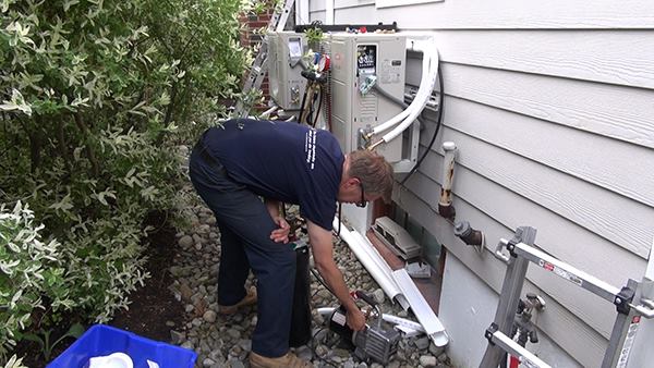

Master plumber Dave Ragsdale purges the refrigerant lines of a 12,000-Btu Fujitsu mini-split heat pump. In tandem, the solar panels and heat pumps will relieve the home's existing oil boiler of much of its annual job.
