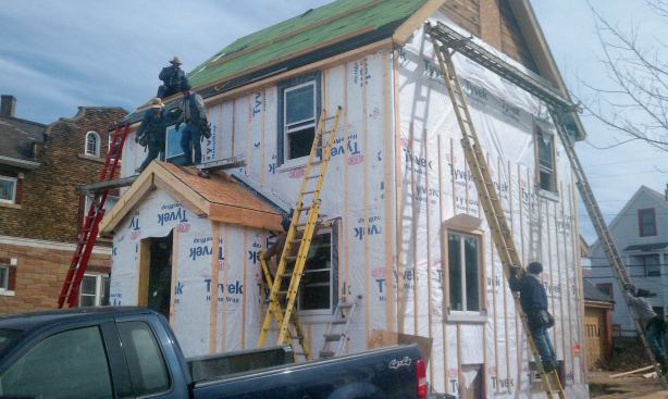

1. Housewrap isn’t installed to be an air barrier. Many people believe that by putting housewrap on a building, they have their air barrier taken care of. But the air barrier’s job is to minimize the amount of air that crosses the building enclosure between conditioned and unconditioned spaces. The real purpose of housewrap is to be the drainage plane behind the cladding, and although housewrap can theoretically qualify as an air barrier material, it must be meticulously installed to effectively stop air leakage.
Builders usually do a decent job taping seams in the field, but rarely at the top edges. To qualify as an air barrier, housewrap would also need to be sealed at the bottom edge, but there’s a good reason why this should never be done: You’ll trap water inside when it gets behind the housewrap and can’t drain out at the bottom of the wall.
Then there are all the mistakes. For example, housewrap at an inside corner often “cuts the corner.” This sometimes prompts cladding contractors—who need to install siding tight to the corner—to slit the housewrap to get it to lie flat. And the innumerable tears, rips, and cuts that occur rarely get sealed before cladding, allowing air to move across the housewrap.
Finally, research shows that housewrap doesn’t work effectively as an air barrier in both directions. We want an air barrier that works in both directions because the building is subject to both infiltration and exfiltration, depending on the direction of pressure gradients acting on a building.
But when we test homes for air leakage, we pretty much always test them in only one direction: from outside to in. We put the house under negative pressure with a blower door and then measure the air flow through the fan, which tells us how much air is leaking in through the building enclosure.
When homes that are air sealed with housewrap are tested under positive pressure, they perform far worse than those same homes tested under negative pressure. The reason for this is probably that air leaking out of gaps in the sheathing pushes the housewrap out, filling it like a balloon, and then the air readily finds the leaks at edges and penetrations through the housewrap and siding.

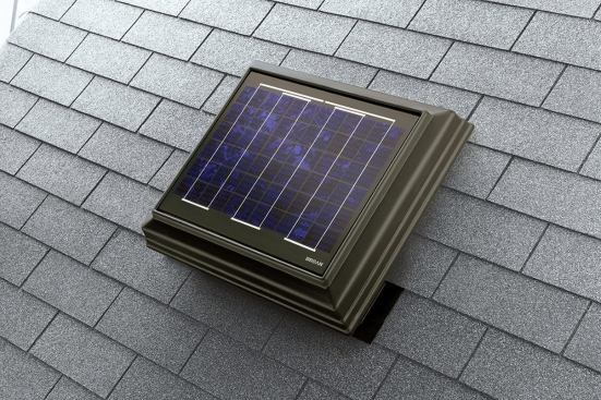

2. Power attic ventilators are a liability, not a feature. While power attic ventilators will probably keep your attic cooler, a significant portion of the cooling in your attic will be provided by your air conditioner.
When that power attic ventilator runs, it’s going to pull air from wherever it can find it. Since air takes the path of least resistance, some of it will likely be coming from the conditioned space in your home. So basically what you’re doing is air conditioning your attic. The longer the fan runs, the more conditioned air it pulls into the attic.

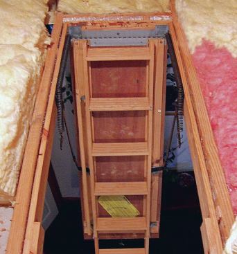

4. A small uninsulated area can make a huge difference in heat gain or loss. Uninsulated can lights, attic scuttle holes, and other bare spots can lead to efficiency and comfort complaints from your clients. One example: Say we have 1,000 square feet of ceiling area and we put R-38 everywhere except at the 10 square feet of the attic pull-down stairs. That mere 1% of uninsulated ceiling results in a 27% decrease in the ceiling insulation’s average R-value. This decrease applies to insulation that’s not uniformly distributed, as well. If you have a lot of lumps in blown attic insulation, for example, you could drastically increase the actual R-value of the ceiling just by raking it smooth.

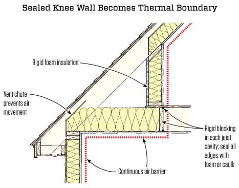

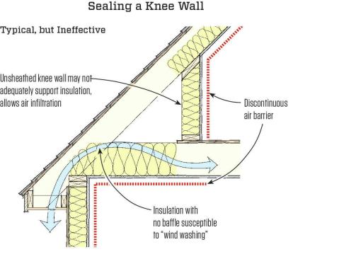

7. Attic knee walls need more insulation and an attic-side air barrier. Those walls around the room in a finished attic separate conditioned space from unconditioned attic space, and they need to be air sealed and insulated like an exterior wall. The problem with many knee walls is that they have fiberglass batt insulation with nothing covering them on the attic side. If the batts don’t make contact with the air barrier (the drywall), air moves through and around them, and they fall out of the attic knee wall. In other words, they’re pretty much worthless.
The state of Georgia, where I work, recognized this problem about a decade ago and started requiring all attic knee walls to have sheathing on the attic side and to be insulated to at least R-18.
The best way to provide the sheathing is to use a rigid material. I’ve seen OSB (oriented strand board), rigid insulation, and structural or non-structural cardboard sheathing materials such as Thermo-ply. I’ve also seen attic knee walls sheathed with non-rigid materials—mainly housewrap—but I think the rigid material will do a better job with air sealing and will stay intact longer.
But no matter what material you use, keep an eye on the electricians, HVAC contractors, and other trades who get in there. Anyone who cuts a hole in the knee-wall sheathing must be held responsible for sealing it.

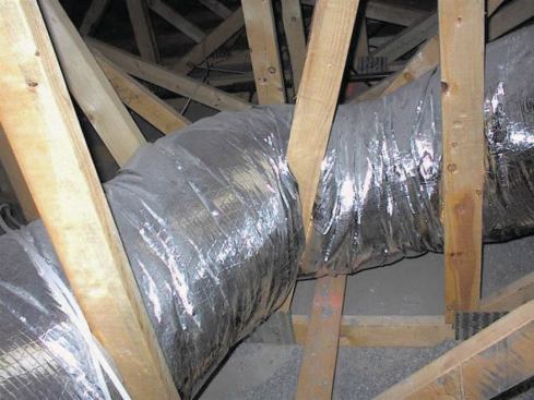

8. Duct systems should not be in unconditioned attics, especially in hot climates. The rate at which heat flows by conduction depends on the temperature difference. An attic can get up to about 130°F in the summer, and the conditioned air entering the ducts is about 55°F or so. With hundreds of square feet of duct surface area in the attic and a temperature difference of 75°F, the air coming out of the vents in your home will be significantly warmer than 55°F. Duct leakage makes the problems even worse.
The report, “Ducts in the Attic? What Were They Thinking?” summarizes research about putting ductwork in unconditioned attics. This report basically says it’s about the stupidest thing we can do in homes that frequently run air conditioners. I encourage you to download it and read it. And if you’re building or remodeling a home, make sure the HVAC contractor gets a copy.
