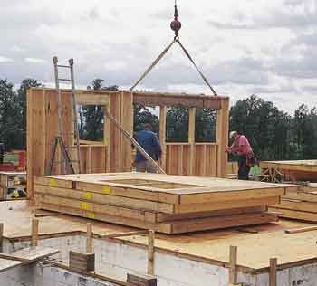

About two weeks after I signed off on the plans, the panels and trusses were ready to ship. As luck would have it, the two flatbed trucks arrived at the site during pouring rain. We piled everything on the ground and called it a day. When the weather cleared, we called the crane back to set the first-floor girder and floor trusses on the foundation, then stacked the subfloor sheathing on top. (Given better weather, we could have done this as part of the initial unloading and saved an hour or two of crane time.) Wall connections. After spending a couple of days gluing and screwing down the subfloor, I scheduled an afternoon session with the crane to set, line, and brace the first-floor exterior wall panels (see lead photo at the beginning of this article). The exterior wall corners were framed with 12-inch-wide “ladders” at the end of one panel, to which the end stud of the adjoining panel is toe-nailed.
The next morning, I positioned and nailed the first-floor interior wall partition, while my helper readied the second-floor trusses and subflooring to be lifted into place (Figure 2).
Figure 2. Bundled second-floor trusses are set atop the first-floor walls. The lumberyard strapped together several sheets of plywood subfloor before delivering it to the job site. The 20-foot-high stairwell panels are visible in the background.
As with the exterior wall panels, partition walls were joined at “ladders” built into the framing. This worked very well and made it easy to align the walls while providing some flexibility in the floor plan (Figure 3). If it doesn’t cause problems elsewhere, nonbearing partitions can easily be shoved one way or the other by a few inches to alter the size of a room or closet.
Figure 3. Partition-wall intersections are simplified by the presence of framing “ladders.” The end stud of the adjoining wall is nailed to the ladder, as shown here, making it easy to adjust the final position of nonbearing partitions as needed.
