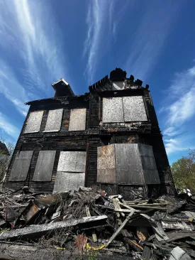

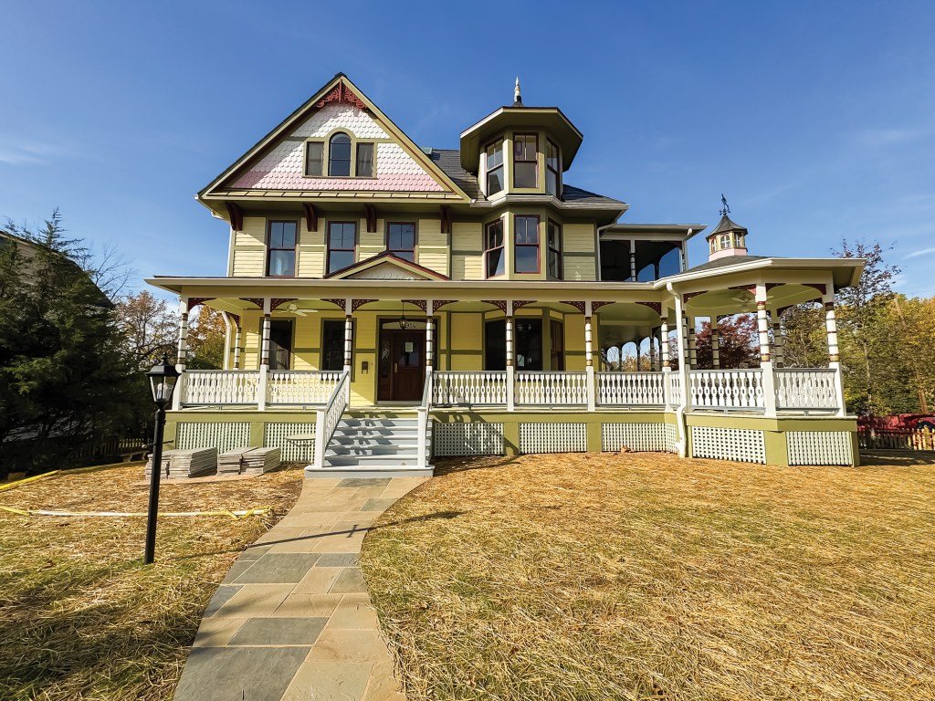

In a story of rebirth, a 1901 Queen Anne Victorian–style house that was destroyed by a tragic fire has become the Queen of Zero—a phoenix of a house rising from the ashes with its architecture true to the original’s turn-of-the-century aesthetic but its performance aligned with the U.S. Department of Energy’s Zero Energy Ready Home (ZERH) standard.
The site is located in a historical district of suburban Maryland just outside Washington, D.C. Though the area was once full of stately Victorians, the stock of these centenarian balloon-framed antiques has dwindled significantly. The neighborhood is now predominantly a mix of mid-century bungalows and newer, production-built craftsman-style houses.
Queen of Zero’s owner, a longtime Maryland resident with a deep appreciation for historical preservation, explained that after the fire, “it was never a question of whether we would rebuild” the original home. Yet, recognizing the demands of a changing climate and rising utility costs, the owner sought to modernize the functional aspects of his new home with advancements in energy efficiency, resiliency, and comfort. To achieve net-zero performance, Queen of Zero incorporated a host of innovative products and materials, such as solar shingles and an exterior shell made of structural insulated panels (SIPs).
As the CEO of Symbi Homes, a greenbuild developer and consulting service, I have worked for more than a decade at the forefront of high-performance homebuilding, seeking to forge new pathways for sustainability in residential construction. At the Queen of Zero project, I served as director of sustainability, working to ensure that the project aligned with our zero-energy goals, while maintaining the integrity of its Victorian aesthetic. I worked alongside an all-star team of veteran sustainable-homebuilding professionals including architect Michael Romero, Matt Kulp and Keyur Shah of Daks Builders, Kelly Gillespie of Kelly Green Energy Raters, and Daniel Santaella of Unik Creative Studio.

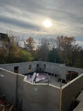

The home was completed in about 13 months, achieving everything we set out to do and then some, as the project evolved over time both at the homeowner’s direction and as a result of our net-zero requirements. In this article, I highlight many of the unique and challenging aspects of this build, discussing lessons learned along the way. The article concludes with my reflections on how this case study can inform a larger effort for advancing high-performance homebuilding.

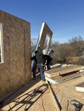

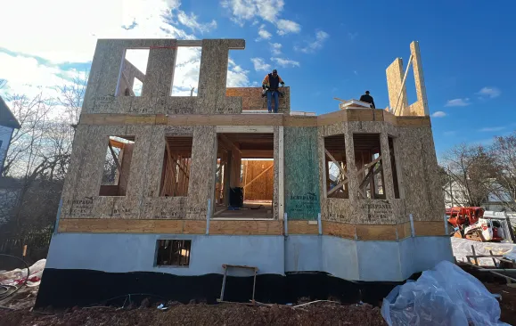

Achieving ZERH certification requires assembling a team of high-performance-homebuilding experts and gathering their input early in the project’s preconstruction design phase. Team members include a third-party green rater with the credentials for certifying ZERH homes who can review architectural drawings for program compliance. In addition, the HVAC contractor and/or mechanical engineer should be engaged early to begin modeling the mechanical systems via the Air Conditioning Contractors Association (ACCA) Manual J, D and S. The builder also needs to complete the Department of Energy’s ZERH training and registration process.
During construction, the green rater will want to stay updated on the progress at each stage of construction. Although ZERH requires only two on-site inspections (pre-drywall and final), there are several requirements that will need to be verified via photo documentation. For this reason, I recommend creating a shared drive of construction progress photos accessible to the green rater in real time.

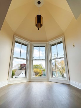

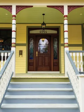

Traditional Victorians are fanciful and embellished—reflective of a moment in history when homes served as artistic expressions and status symbols made possible by the invention of power tools and a growing middle class during the Industrial Revolution. This architectural vernacular of elaborate trim details and intricate brass fixtures may seem at odds with the concept of a newly built net-zero home, which often conjures the image of a minimalist contemporary house or off-grid cabin.
However, from a theoretical perspective, the high-performance features of a net-zero build exist primarily outside the realm of embellishments, focusing on the mechanicals, wall systems, windows, insulation, and air-sealing (the “guts” of the home). For this reason, much of the Queen of Zero project followed a typical playbook for constructing a ZERH-certified home, with some exceptions when the aesthetics and performance seemed to duel. For example:

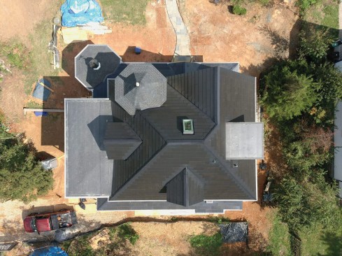

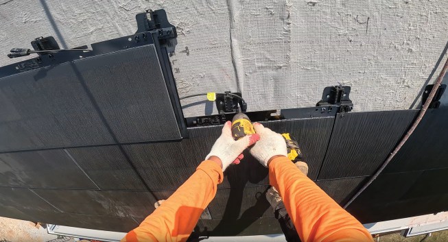

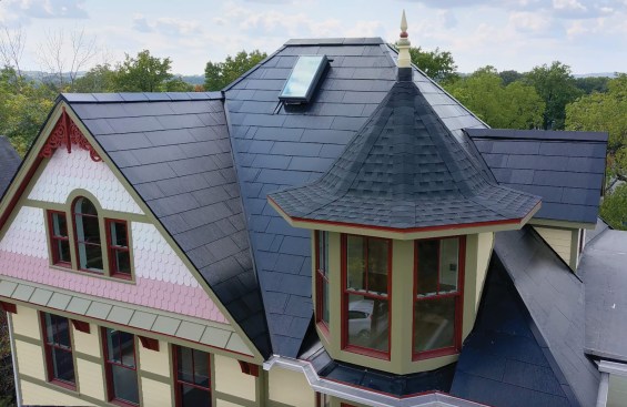

Rooftop renewables. The complicated roof structure with its many pitches, hips, and valleys meant that installing solar panels would be virtually impossible and practically useless, especially considering the county’s setback requirements. Thus, the decision was made to source a Tesla Solar Roof with the added bonus of the material’s low-tech look resembling historical slate shingles. The Tesla solar installers recommended a naturally vented roof, which proved challenging due to the complicated roof design and the fully unvented third-floor attic space. To solve for this, the team opted to install the roof sheathing on 1-by purlins, holding these a couple of inches back from the hip and valley rafters to provide a channel for air to flow past the purlins at these locations.
The complex roof plane left little room for conventional photovoltaic panels but worked well for Tesla Solar Roof shingles.
These shingles mimic the look of historical slate shingles. However, the Tesla shingles require a naturally vented roof, which proved challenging with all the hips and valleys that block airflow through many rafter bays.

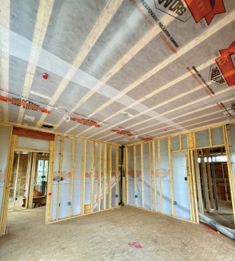

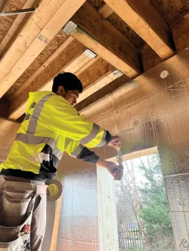

Air-sealing and insulation details. To be sure, a nice, flat, continuous wall is much easier to air-seal and insulate than one with a variety of projections, curves, or funky angles. Yet, Victorians favor dormers and bay windows, which are notoriously leaky. And the rafters of a turret roof contain dozens of nonperpendicular angles. With each architectural detail in the Queen’s structure, our crew had to pay particular attention to how these spaces would be properly insulated and air-sealed, using a variety of products (spray foam, cellulose, caulk, rigid insulation, etc.) to get the job done.

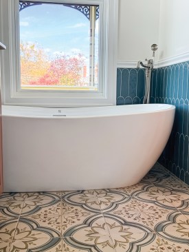

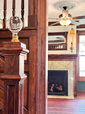

Low-emission finishes. The tighter the home, the more critical it is to avoid adding materials that emit indoor air pollutants such as VOCs. However, when it comes to wood finishes, low-emission products are typically lighter in color and sometimes difficult to apply. The hardwood flooring installers refused to use a water-based product, for example, because of the challenges in covering a large room without areas of patchiness or uneven finish. Fortunately, we found a great product—ProCoat UnoCoat Hardwax Uroil, a no-VOC stain that provides consistent coverage in a variety of dark, rich colors that perfectly matched the wood trim.

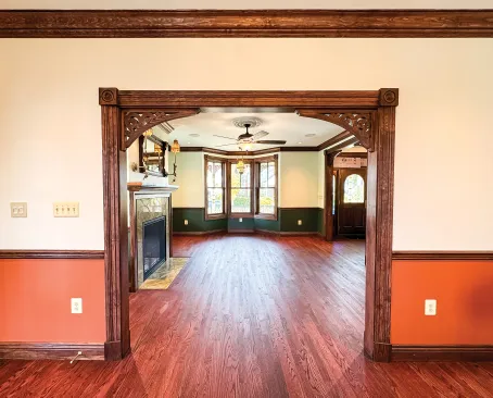

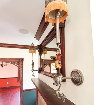

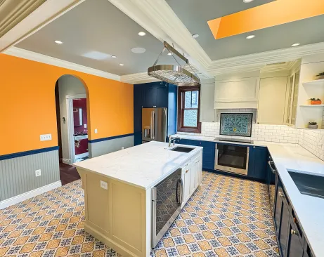

LED lighting. ZERH homes reduce energy costs in part by requiring LED bulbs in all lighting fixtures. When the design calls for period lighting (as in, the period when electricity was invented), LED fixtures can be scarce, but many antiques can be retrofitted with LED bulbs that mimic the original look. At the Queen of Zero, the homeowner purchased several decorative antique lights that were expertly and beautifully retrofitted for efficiency.

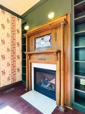

Cozy fireplaces. Ideally, a well-sealed ZERH home would not include any combustible gas appliances or equipment that might introduce toxins into the indoor air. Victorians are known for their multiple fireplaces with decadent mantels and hearths, cherished family gathering spots. I asked the homeowner to consider a variety of electrical inserts—typically LED-glowing fake logs with a background video playing flickering flames—for the home’s two prominent fireplaces. He understandably turned me down and instead opted for direct-vent gas inserts with fixed, flush glass fronts.

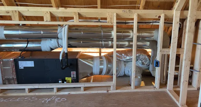

Designing an optimal heating, cooling and ventilation system for the Queen of Zero was no easy feat, especially considering its location in Maryland (zone 4A), a mixed climate with high humidity levels. Our team of mechanical experts needed to address both comfort and efficiency in a tight home conditioning all four floors with a segmented layout typical of Victorians.
Now that the home is near completion and the system is operational, I can attest to the superior level of comfort (thus far) throughout all four levels of this 4,800-square-foot home. In September with outdoor temps near 80°F and humidity an average 74%, the Queen’s interior achieved a consistent 72° and 45% humidity, even in the finished attic space on the third floor. Most notably, the home stayed relatively comfortable during workdays when a constant stream of crew members entered and exited the property’s seven exterior doors.
System components. The Queen of Zero is heated and cooled via four high-performance cold-climate heat pumps manufactured by Mitsubishi Electric HVAC US. With the exception of the basement music room, the house is conditioned via three ducted air handlers serving 1) first floor and partial basement; 2) second floor; and 3) third-floor finished attic. The basement music room, built with extensive sound-attenuation materials in the walls and ceiling, has a dedicated wall-mounted mini-split for heating and cooling—a ductless system designed to reduce sound-wave transmission to adjacent areas of the home.
At the jobsite, we have a saying, “This is not your grandmother’s Victorian,” and the final mechanical design is a perfect example. Despite the home’s conventional turn-of-the-century layout with its many segmented rooms and despite the central staircase that encourages the stack effect of warm air rising to the upper floors, the compartmentalization of the Queen’s HVAC into four distinct systems, each with its own thermostat and controls, ensures optimal comfort in all areas of the home. Gone are the days of sweltering attic spaces and chilly, damp basements.
As per ASHRAE 62.2 ventilation standards, the tight envelope of this high-performance home (less than 2.0 ACH50) requires a whole-house mechanical system to help circulate fresh air. We selected an AprilAire V22BEC Energy Recovery Ventilator (ERV), which transfers much of the energy used to heat or cool the indoor air from the exhaust air to the intake stream as it dumps fresh, filtered air into the supply side of the Mitsubishi Electric SVZ-KP24NA air handler. The V22BEC ERV also pairs with AprilAire’s 8120X Ventilation Controller, which monitors outdoor temperatures and will adjust its schedule to avoid bringing in fresh air during the hottest, most humid times of day.
To control humidity in the house, we added an AprilAire whole-home dehumidifier to each heating and cooling system. Importantly, these units can monitor indoor humidity levels and operate independently from heating and cooling demands. In other words, even in conditions where the thermostat is not calling for cooling, the dehumidifiers will run to remove excess humidity from the conditioned space. Similarly, a whole-home AprilAire 800 Steam Humidifier connected to the first-floor air handler will add humidity to the home during dry winter months—even when the thermostats are not calling for heat.

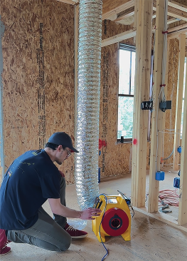

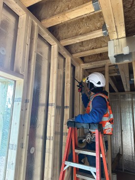

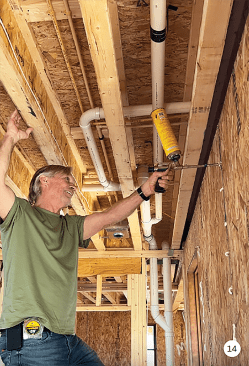

The ZERH program follows Energy Star standards for maximum allowable duct leakage. For this project, duct testing measurements could not exceed 6% air leakage (≤6 CFM25 per 100 square feet of conditioned space). Increasingly, local municipalities are also requiring duct tests to pass final residential building inspections. The requirement makes a lot of sense—leaky ducts reduce thermal comfort, decrease the efficiency of mechanical systems, and increase the cost of utility bills. Such rigorous duct leakage testing is a significant shift in the work processes for many residential HVAC professionals, who may not be accustomed to such scrutiny. I have yet to find a system that passes on the first manometer reading.
Retrotec’s Noah Lawrence assisted with pre-drywall duct testing. His initial tests did not go as planned—results showed approximately 12% duct leakage, which is double the allowable amount for ZERH certification, on all three ducted systems. We worked with the HVAC contractors over several days chasing theatrical-smoke trails to find and plug the leaks before we finally managed to get the duct leakage below 6% at pre-drywall. One lesson learned: We should have tested the attic systems prior to spray-foam installation, as it was difficult to reach some leaks in the tight cavities behind the knee walls.
Because this process of sealing the ducts can be labor-intensive, it is important to include the standard for maximum allowable duct leakage in the HVAC subcontract so expectations are clear up front. Also, it helps to clarify who will be responsible for additional consulting fees if the green rater needs to make multiple trips for testing and diagnostics.

Equipment Integration

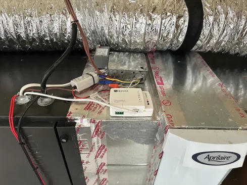

In total, 14 pieces of mechanical equipment regulate the Queen’s indoor air and operate in harmony to ensure optimal comfort for her occupants. To help manage the system from a user perspective, Appadoo opted for Ecobee Premium Pro Wi-Fi-enabled thermostats, which allow the homeowner to control the complex system from one app on his cellphone.
However, because there are some limitations of the Ecobee thermostats pairing with Mitsubishi Electric air handlers, Appadoo used an Airzone Aidoo Pro module to integrate the Mitsubishi system with the Ecobee Premium Pro thermostats and AprilAire dehumidifiers. According to Appadoo, “This setup allows all parts to work together seamlessly, providing optimal temperature and humidity control tailored to the home’s needs.”
Tweaks to the System
Despite our concerted efforts to model the mechanical loads and duct design, the system has still required some adjustment. For example, we found that the system sometimes struggled to keep up with afternoon solar heat gain in the kitchen from a 2-by-4‑foot skylight. Fortunately, the homeowner had the foresight to purchase a solar shade with his Velux FCM 2246 skylight, which solves this problem.
