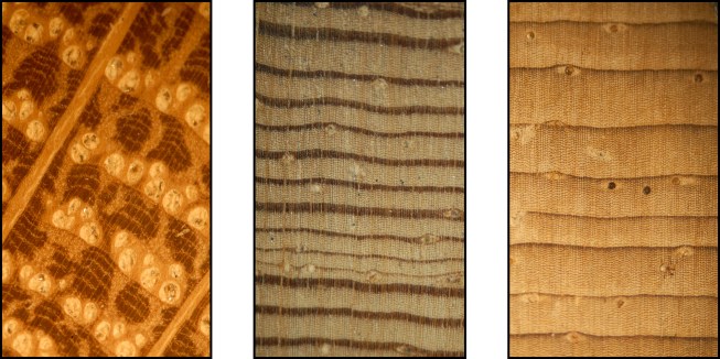

Sample growth rings of oak (left), pitch pine (middle) and white pine (right).

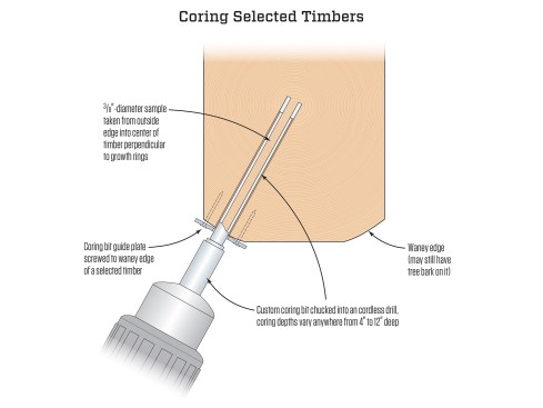

Coring. I take a core sample at each selected timber. Typically, 10 to 20 core samples are needed per project for comparison and to allow for some not dating, for one reason or another.

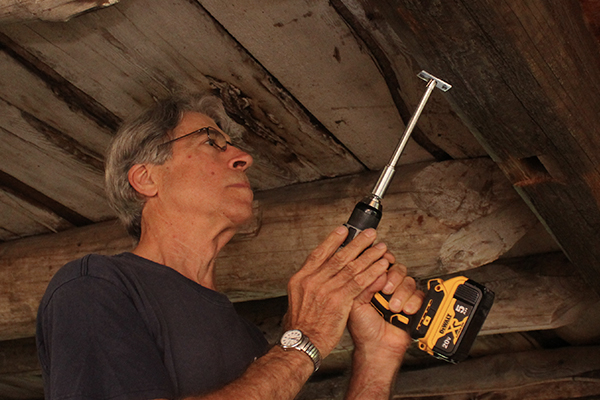

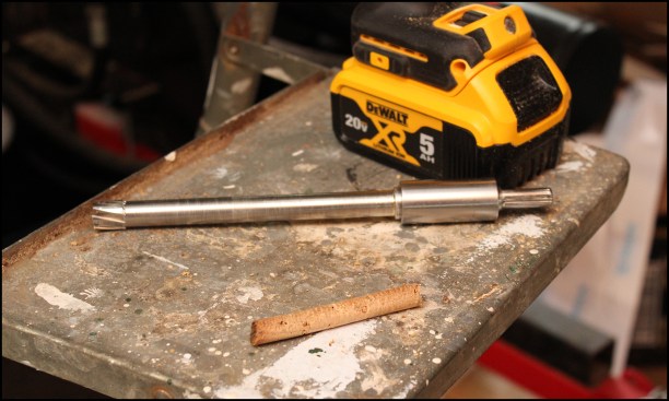

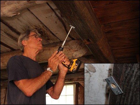

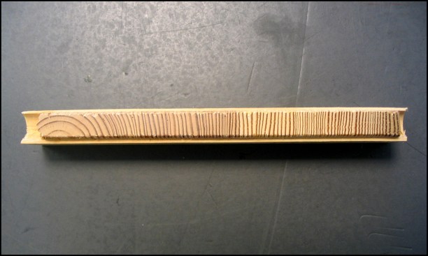

After attaching a guide plate to the waney edge of a selected timber, I use a custom coring bit chucked into a cordless drill to obtain a 3/8-inch-diameter sample. My goal is to drill from the outside edge into the center of the timber perpendicular to the growth rings. As the center of the tree is not always in the center of the timber, it’s not uncommon to drill a bit past the middle and a bit to one side or the other (which yields the semicircular growth rings shown in pitch pine sample below). This does not affect the results.

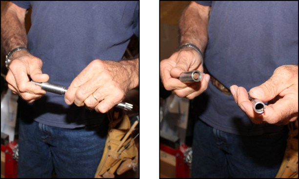

The custom coring bit doesn’t readily expel sawdust, so I work slowly and repeatedly pull out and clear the drill bit flutes while coring. If the core stays intact throughout the drilling process, it is removed from the timber with the use of a thin metal rod with a sharp “L” tip that is slipped down the side of the core and twisted to cut through the base of the sample, which can then be removed. Should the sample break during coring, I simply separate the coring bit from the drive adapter and remove the cored sample from the drill tube. Coring samples run anywhere from 4 to 8 inches in length (or longer, in rare instances). When cores break during sampling, it is often possible to accurately reglue clean breaks without losing rings.
I label all the samples and enter them into a log book that notes the position of each sampled timber within the structure, its species, whether it has wane, and any other information pertinent to the sample.
The author attaches a guide plate to the “waney edge” of a timber (inset photo), then takes a sample at each selected timber using a special coring bit.

Should the sample break during coring, the custom coring bit (left) separates from the drive adapter (right) to …
… allow the core sample to be removed from the drill tube.

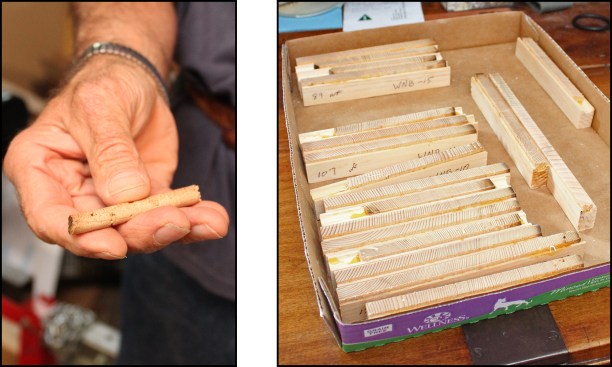

Prepping samples. Back at home, I glue the core samples into custom wood mounts, longitudinally, as if you were looking down the tree in section view. The mounted samples are numbered (corresponding to the log book information) and then sanded down using successively finer grit paper with a benchtop belt sander (150 grit) and hand sanding (220, 400, 600 grit) to create a mirror-smooth finish.
Core samples (left) are glued longitudinally into custom wood mounts and are sanded down using successively finer grit paper to a mirror-smooth finish. Here, recently cored spruce samples from a barn in Whately, Mass., are ready to be measured (right).

This sample of pitch pine, which is a northern hard pine similar to southern yellow pine, displays contrasting growth rings.
William Flynt

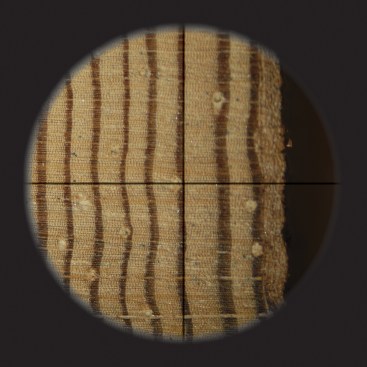

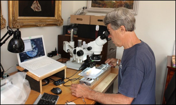

Measuring tree ring growth. I view all the samples using a low-power stereo zoom binocular microscope fitted with crosshairs in one eyepiece to ascertain and mark the number of rings per sample. This is followed by a visual review of all samples to determine if site-specific growth patterns can be picked out. Each sample is then placed under the microscope on a sliding stage calibrated to read to the nearest micron (.001mm), tied electronically to a computer. Measuring begins at the outer, or last year of growth ring, established as 1000, and proceeds to the center of the sample or first year of measure (the waney edge is assigned the number 1000, the second-to-last ring is 999, and so on, down until the earliest ring in the sample is measured). Working with the measuring program J2X, I measure the width of each ring by moving the sliding stage with its rotating gear system and enter the width into a J2X computer file by clicking a start-stop button, similar to a mouse. Depending on the number of samples and the ring counts in them, measuring can take a couple of hours to more than a day.
Each sample is placed under a stereo zoom binocular microscope on a sliding stage with a micro-adjustment knob calibrated to read to the nearest micron.
Here, a pitch pine sample is viewed under a microscope fitted with crosshairs in one eyepiece; the waney edge is on the right.

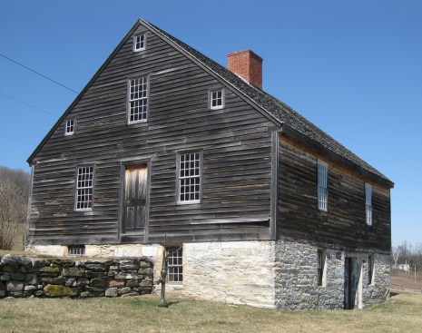

Sample Project: The Ephraim Fisher House, Orwell, Vt.

Example. Analysis can be complex and difficult to explain in a short article. To get a sense of what the results of a dendroarchaeology study look like, see Sample Project: The Ephraim Fisher House, Orwell, Vt. The study shown (see photo, above) was essentially a dendrochronological “home run”—because of how well all samples aligned among themselves as well as against dated masters—and was thus chosen for illustrative purposes. Not all studies are successful, though by my estimates, success is achieved approximately 85% of the time.
