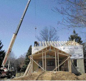

Wednesday: Standing Walls
The next morning, we finished patching the floor framing and subfloor. When the crane arrived, just after lunch, we set the wall panels and trusses for the family-room addition. Then we had the crane lift the walls for the second story onto the floor deck, setting them directly over a bearing wall to avoid cracks in the finishes below.
On its first visit, the crane lifted the second-story wall panels onto the deck. Wall framing took a day.
Rather than keep the crane sitting around while we set the walls, I sent the operator away, which kept the bill to a three-hour minimum charge. This gave us the whole afternoon to set walls, so we spent a little extra time wrapping them with housewrap before standing them.
