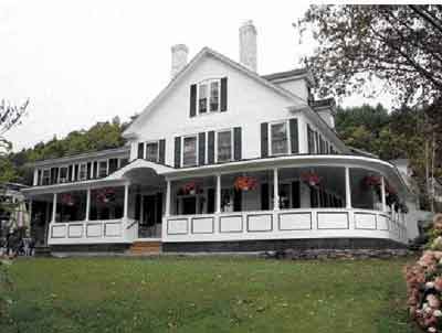

Stowe, Vt., is a classic New England town. One of its oldest and most visible structures is the historic Stowe Inn, located near the center of the village. When its owner decided to expand the dining room by adding a large wraparound porch, I was glad to get a call to discuss such a highly visible project.
Because of the building’s historic status, the town’s historic preservation commission insisted that the porch look like it had been around for a long time. Accordingly, the architect designed a porch reminiscent of those from the late 1800s. Most notably, the design included a rounded outside corner, a signature Victorian element.

Other than the curved corner and a barrel vault over the inn’s front door, the porch design was conventional. We built a 2×10 pressure-treated floor system supported by 6×6 posts bearing on concrete piers spaced about 8 feet apart. To support the joists at the curved corner, we glued up a rounded girder from six layers of 1/2-inch pressure-treated plywood. The joists bear directly on this girder, and terminate in a curved band joist, which we laminated from three layers of 1/2-inch PT plywood. We also placed posts and girders near the building, so that most of the loads from the deck — which would support 100-psf commercial loads — would be carried directly to the ground, not to a ledger attached to the building.
We spent a little extra time laying out a double floor joist coming off the building’s outside corner at 45 degrees — or as close to 45 degrees as we could make it, given that the old building was not perfectly square. Since we planned to lay out the roof framing above from the same diagonal reference, we wanted it to be accurate.
To support the porch roof, we attached a ledger to the solid brick building with a combination of 3/8-inch lags and lead shields and epoxied threaded rod. At the eaves, we used three-layer built-up 2×8 beams for the straight runs and a laminated beam for the radius, all supported by fiber-reinforced synthetic columns.
