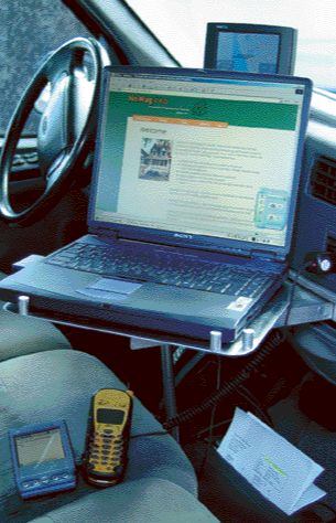

Like most builders today, I rely heavily on my laptop computer. Despite the name, though, laptop computers don’t really work very well on your lap. They tend to slide around when used that way, making it difficult to view the screen and enter data efficiently.
A mobile computer mount. My solution to that problem was to install a computer table in the dash of the truck, between the driver and passenger seats (Figure 3). The table was designed and built by an old friend, Dave Vargas, who is a fine machinist.
Figure 3.A computer table made from aluminum angle, bar stock, and 3/16-inch plate is mounted in the dashboard cupholder slot and receives additional support from an aluminum rod that rests on the floor. The table can be locked to left, right, or center, making the author’s laptop computer accessible from the passenger seat or — when the truck is parked — from the driver’s seat.
The strong aluminum table fits precisely into the empty slot left in the dash after the cupholder is removed. (The cupholder is designed to be removable, so that doesn’t require any alteration or damage to the dashboard.) A built-in lazy susan bearing from a cabinet supplier allows the table to swivel to the left or right, making it easy to use from either driver or passenger seat. It can be locked in either position or in the center.
This not only works well, it also attracts attention wherever I go. My tech-savvy clients always remark on it, and when I took my truck to the local Ford dealership recently, the entire service department came over and crowded around it. If this were manufactured commercially, I’m sure it would be a hot-selling item.
[To see a mechanical drawing of the author’s aluminum computer mount, click here.]
Paper to go. Cell phones and wireless e-mail are great, but plenty of job-site functions demand some sort of paper. For example, I often need to print out specs, drawings, or other materials I receive by e-mail so I can pass them along to subs or clients. It’s also much easier to print change orders in the field and get the necessary signature on the spot than it is to haul the right paperwork from the office.
I handle job-site paperwork with a basic black-and-white Canon Bubble Jet printer, which costs about $150. It’s attached to the carpet between the driver and passenger seats (under the computer table) with two strips of self-sticking Velcro tape. The “hook” half of each strip, which is stuck to the base of the printer, mates firmly to the pile of the carpet, with no need for the corresponding “loop” strip.
Having the printer available lets me make a hard copy of anything on my hard drive at a moment’s notice. If customers question an item on the bill, for example, I can print out a copy of the e-mail from them that authorized it. As a result, we almost never find ourselves in confrontation mode with our clients.
