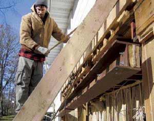

Concerned that this might create an unstable cantilever, I also decided to install diagonal supports on the outside — like the kind of temporary supports you'd use to hold up a porch roof while you rebuilt the floor. This meant building a temporary wall under the floor of the addition to provide a continuous load path for the diagonal braces to the ground.
In building the temp wall on the inside, I decided to cover it with 1/2-inch plywood and install fiberglass batts to give the homeowners — who were living in the house during the job — some weather protection.
Luckily, the GC took care of removing the asbestos siding from the area where the addition was going; to get started, we just had to pull off the sheathing and remove an existing window and door. Before installing the diagonals, we fastened a temporary 2x10 ledger above the new opening, using 1/2-inch lag screws. We predrilled the studs to prevent splitting, and used plenty of 16d commons as well.
After placing the 2x8 diagonals, we attached a second ledger underneath to prevent them from slipping and to contain the inevitable splits at the notches. We nailed them off at their bases to a plate secured to the floor framing.
A 2x10 ledger fastened to the studs with 1/2-inch lag screws serves as an attachment point for the 2x8 diagonal braces.
A second ledger beneath the top end of the braces keeps them snugly in place and helps prevent splitting. A sheathed, insulated 2x4 wall on the inside picks up the second-story floor loads.
