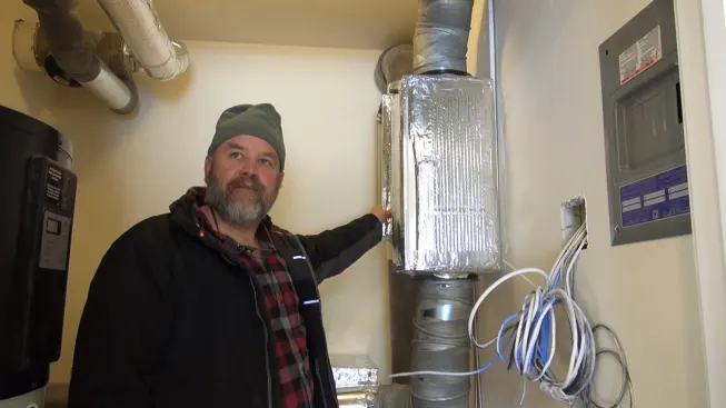

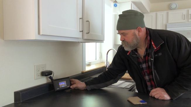

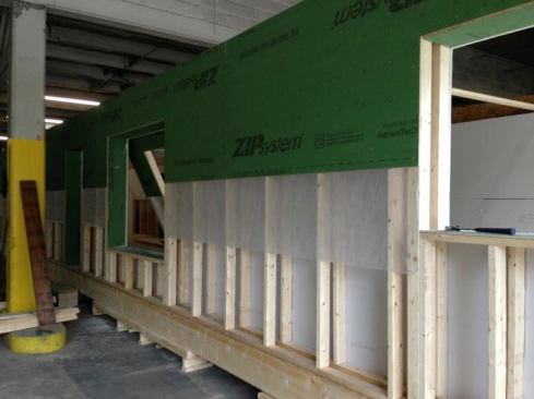

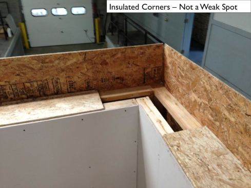

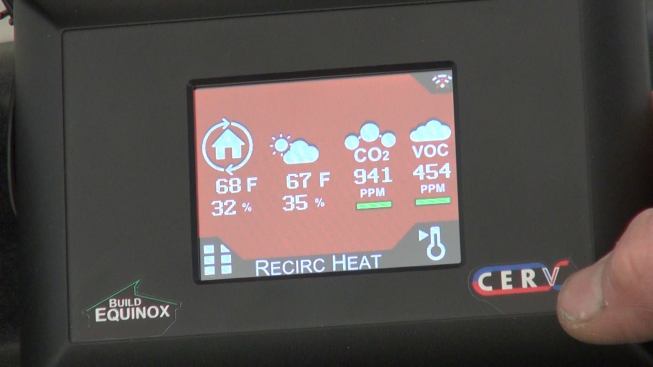

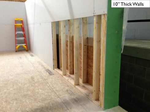

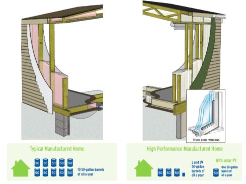

The state’s solution was to evolve a new generation of housing units the same size and shape as a traditional HUD-Code mobile home — but constructed entirely differently, with airtight super-insulated double-stud walls, state-of-the-art heat pump heating and cooling systems, and innovative “Conditioning Energy Recovery Ventilation” equipment that recovers heat from outgoing or incoming air as needed using a heat pump, not just a passive heat-exchanger core. (The CERV units, supplied by Illinois startup Build Equinox, also come with a sophisticated “black box” control unit that responds to indoor carbon dioxide or VOC content, exchanging air with the outdoors whenever indoor conditions warrant — but not if they don’t.)

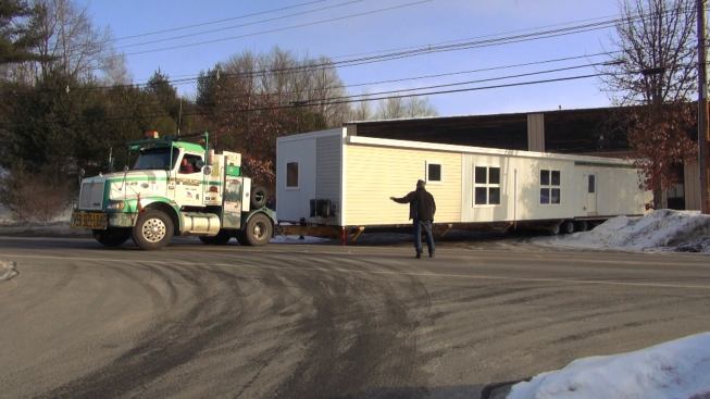

The advanced units were designed with input from existing mobile home residents by David Pill of Pill-Maharam Architects (WebsiteProfile). Schneider’s job is to manage the mobile home replacement effort’s technical requirements, program planning, and implementation. Steve Davis, founder of Wilder, Vermont, company VerMod, Inc., has the job of getting the units built and delivered. So far, VerMod has set more than 20 of the units, and is pumping them out at a rate of about one a month — for a price of about $105 per square foot at the factory gate, or about $140 a square foot installed and move-in ready.

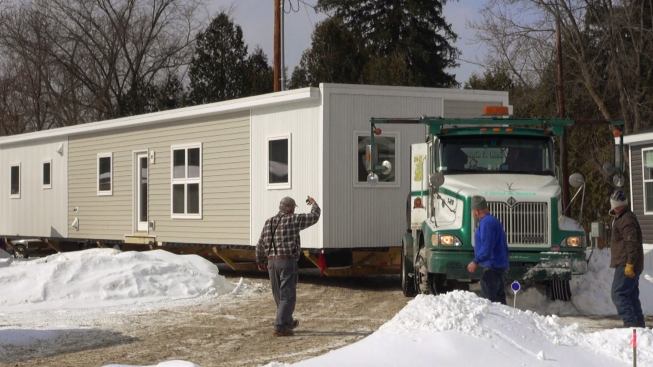

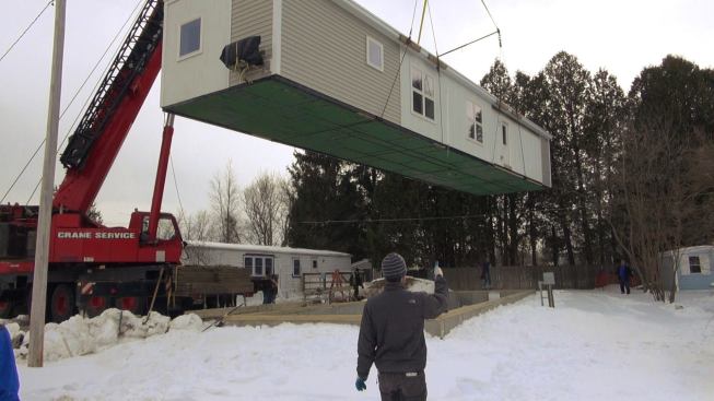

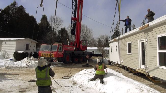

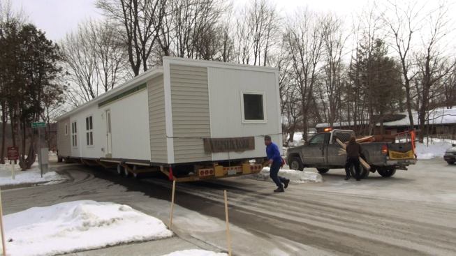

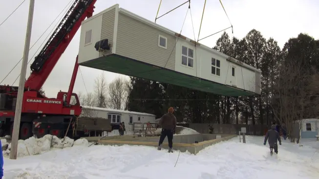

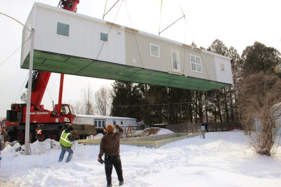

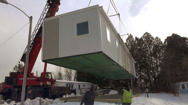

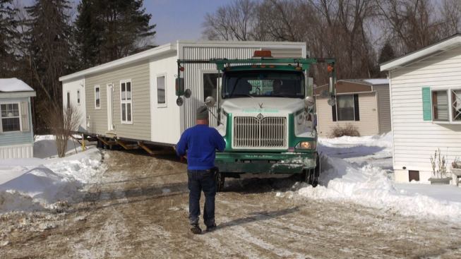

JLC visited the VerMod plant in Wilder in February, and accompanied Davis on a trip to Shelburne, Vermont, to set a brand-new unit. For a look at the process, view the slideshow.
