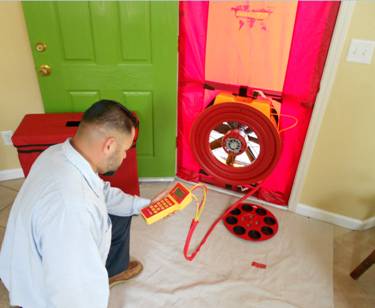

A blower door is a primary tool for locating leaks in the building envelope that can lead to unhealthy indoor air.
ABC Cooling & Heating

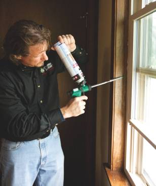

Sealing air leaks and providing controlled ventilation can improve both indoor air and energy efficiency.
Dr. Energy Saver
