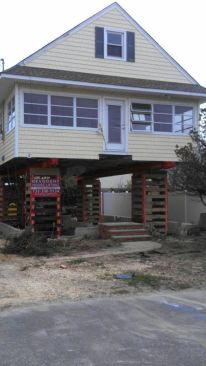

Robin Baine knows a thing or two about dealing with natural disaster aftermath. She and her husband are the co-owners of Baine Contracting, based out of Point Pleasant, N.J., which had many customers hit by 2012’s Superstorm Sandy. “You’re running a company with employees and you have no place to send them to,” Baine told REMODELING. “For about two months after the storm, we were spending most of our time taking care of people who needed our help to secure their properties.”

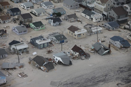

Homes destroyed in the wake of Superstorm Sandy in 2012 (Photo courtesy of the U.S. Wildlife Service and Greg Thompson/USFWS via Flickr).

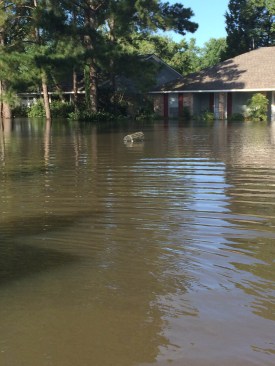

Ben Waldman of Living Craft Design-Build also has extensive experience working in disaster recovery areas. In 2003, Waldman began volunteering in disaster recovery efforts during Hurricane Katrina, which started a journey in helping other communities rebuild. He’s helped victims after Superstorm Sandy, the 2010 earthquake in Haiti, and the 2013 Colorado floods. He now runs a worker owned cooperative in Denver, Colo.

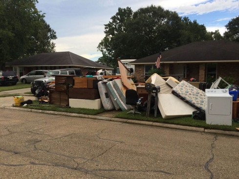

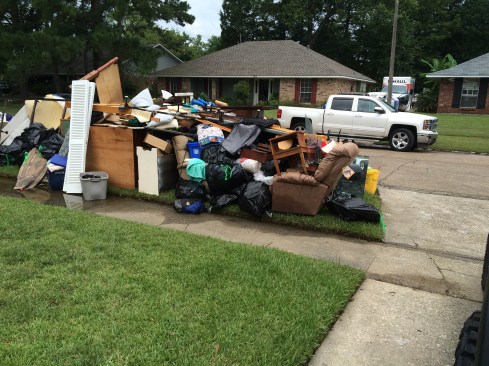

Waldman helped his own family after the recent Louisiana floods, “The biggest thing I’ve learned is that it is no different than any other remodeling project,” Waldman says. “It takes a lot of trust and patience and hand-holding and really guiding folks through that process. It is a huge overwhelming situation. … You have to have a lot of compassion and understanding.
What are Waldman’s first steps towards recovery? Getting a damaged house to a point where no more damage is happening and getting people into a temporary safe place.

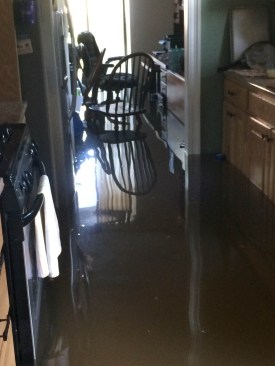

With flooding, Waldman recommends to get as much wet material, such as carpet and furniture, out to dry as possible. Make sure that you have air circulating to help dry concrete slabs and studs that are soaking wet. Be sure to get some sort of ventilation or AC system going if you are expecting high temperatures in the area. In Louisiana, temperatures during the summer average 90 degrees where, as Waldman puts it, “mold is just super happy.”

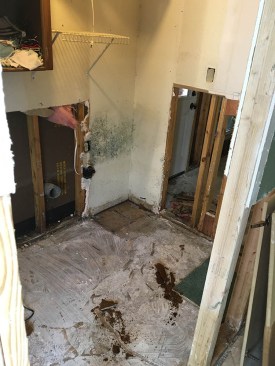

The drying process takes the longest and requires the most patience. “It can be deceiving,” he says. “It can look like your house is super dry. When I left my folks’ house in Baton Rouge, compared to the first day that I went in there and they were still gutting, it felt great. You know, the humidity was at a great level in there, everything was mostly dry to the touch at that point. But you take a moisture meter and take measurements around the building and you quickly discover things are mostly still wet—and wet enough that if you put drywall up, mold would start to grow.”

After everything has dried, it’s important to disinfect every surface and remove any visible mold by using a wired brush, Waldman says. He suggests using vinegar or borax, instead of bleach, to disinfect and remove any mold spores
“To sum it up,” Waldman told REMODELING, “gut, dry, mold removal, disinfect.”
