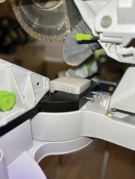

Jack Colliflower, a woodworker and owner/designer of Colliflower, in Cheney, Wash., has fixed both problems in one swift step with the Cube for Kapex Zero-Clearance Fence. This accessory consists of a black powder-coated fence base milled from 6061 aluminum that completely replaces the original Kapex fence base while still employing the existing mounting holes and bolts on the Kapex.
The Colliflower Cube system, comprising a black, powder-coated aluminum fence base and a plastic block.

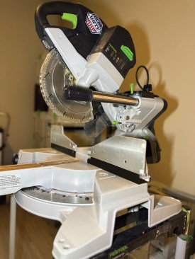

The system marries easily to a Festool Kapex saw using the saw’s existing bolts and holes.

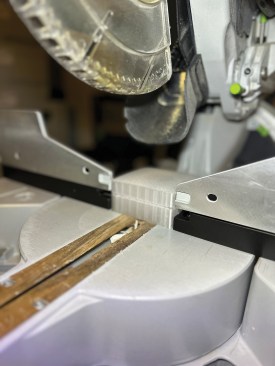

At the heart of the Colliflower system is the Cube, a 3 1/2-inch-by-3 1/2-inch by 2-inch-high clear PETG (thermoplastic polyester) block that occupies the once-empty space between the auxiliary fences. This block is slotted around all four sides to fit snugly within the Colliflower replacement fence base and becomes its own sacrificial fence without sacrificing depth of cut or dust-collection capability. With the Cube in place, safety and accuracy are enhanced, and tear-out on the back of the cut is eliminated, regardless of the angle of cut.
Since the Cube is symmetrical, you can rotate it to use all four sides when making sacrificial cuts, extending its life. To replace it, you can buy new PETG cubes from Colliflower for about $20 each, but it’s easy to make your own cubes with offcuts from a 4x4. It’s possible to make custom cubes taller than the PETG cubes, but you’ll get better dust collection by limiting the height to about 2 inches.
The Cube fits the fence’s throat completely to prevent fly-aways and reduce material tear-out but doesn’t impede dust collection or limit depth of cut.

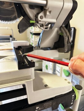

Adjustment bolts ensure that the Cube remains aligned with the front of the fence.
