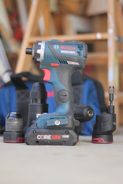

The kit came with a 4.0-Ah battery and charger, a nylon tool bag, and three different attachments: a standard 1/2-inch keyless metal chuck; a right-angle attachment, also with a keyless chuck; and an offset-angle attachment, which has a 1/4-inch hex bit holder with quick release. Also available is an optional rotary hammer adapter that accepts SDS-plus bits for drilling into masonry. That’s four optional attachments; so what’s option number five? The drill/driver is designed with an integral 1/4-inch hex bit holder, and in tight spaces can be operated like an impact driver, without any of the attachments. Keep in mind, though, that it is a drill, not an impact driver, though it does have an adjustable clutch mechanism that seems to operate a little more precisely than the clutches on my other drills.

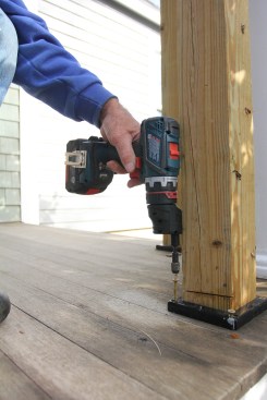

Bosch’s Flexiclick drill/driver's integral 1/4-inch hex bit allows it to be operated without any attachment.
The driver comes with three attachments, including an offset-angle attachment for driving fasteners close to an adjacent surface.
