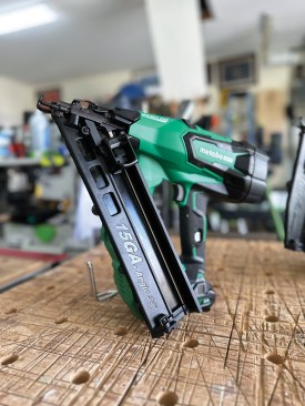

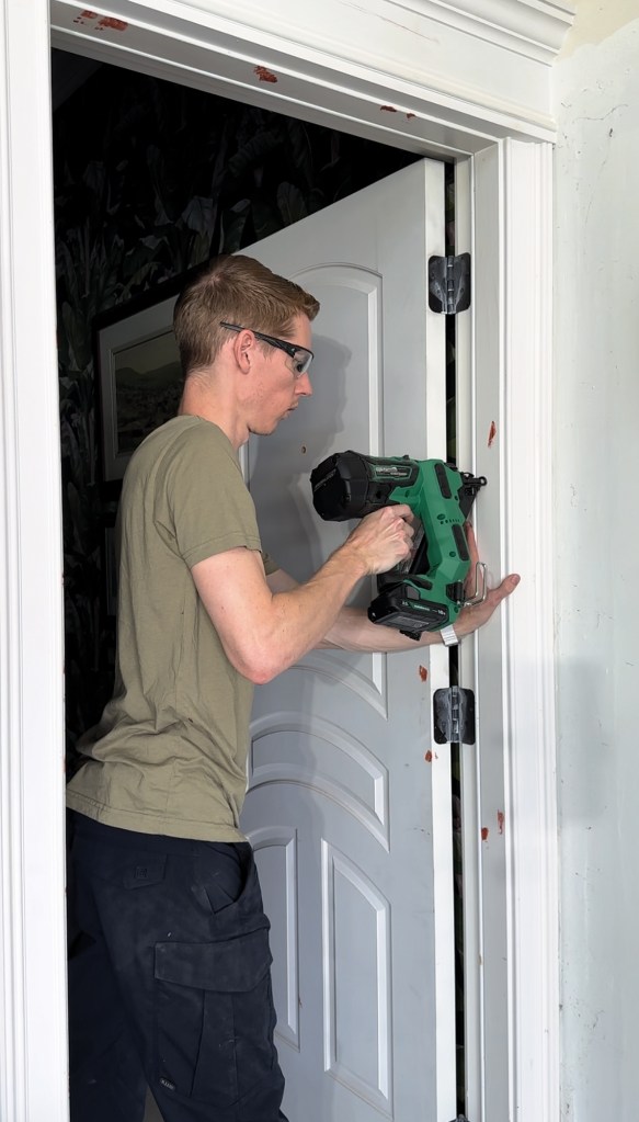

MultiVolt Brushless 15-Gauge Angled Finish Nailer. This nailer (NT1865DMAS) is a versatile and powerful tool capable of shooting 15-gauge nails up to 2 1/2 inches long, a recommended length for installing interior door jambs. With this great power comes increased weight—7.6 pounds without a battery—something that I definitely noticed when nailing overhead. On the other hand, the added weight didn’t bother me when I was installing interior door jambs, and I didn’t have to worry about tripping over a hose while moving the door slab back and forth.
For trim work that requires holding power, the author turns to Metabo HPT’s MultiVolt 15-gauge angled finish nailer (NT1865DMAS), which can shoot nails up to 2 1/2 inches long.
This gun has a standard magazine capacity of 100 nails ranging in size from 1 1/4 inches to 2 1/2 inches, and it can shoot up to 800 nails per charge with the new, smaller, 2.0-Ah compact battery that comes with the kit. While the compact battery saved on weight, I found the battery life to be far less than that of the larger Metabo batteries, so for installing door jambs all day, I opted for one of the larger MultiVolt batteries that are compatible with the nailer. This nailer has a dry-fire lockout and comes with a built-in belt hook, but with the additional weight, I tried to keep the gun on a rolling cart versus my toolbelt when not in use. Suggested retail price: $300.

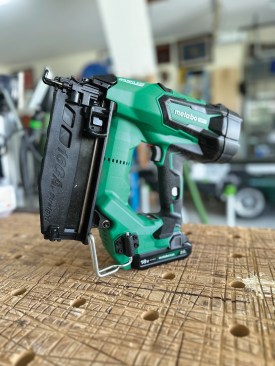

MultiVolt Brushless 16-Gauge Straight Finish Nailer. I consider this gun (NT1865DMST) to be the Swiss army knife of nailers and find myself using it for fastening larger trim details such as poplar crown where I need the holding power without the large hole that a 15-gauge nailer leaves, as well as for fastening smaller trim. It weighs in at 6.6 pounds without a battery, a weight I found bearable but certainly noticeable when on my belt or at the end of the day. This nailer also has a built-in belt hook that can fold out of the way and dry-fire lockout.
Metabo HPT’s 16-gauge straight finish nailer (NT1865DMST) weighs about a pound less than their 15-gauge nailer and leaves a smaller hole. It's great for nailing up crown molding and other trim details.
With the 2.0-Ah compact battery, the 16-gauge finish nailer is capable of shooting 950 nails per charge, and up to three nails per second with zero ramp-up time. The magazine capacity is 100 nails ranging in size from 1 inch to 2 1/2 inches, making the nailer suitable for a variety of applications. Suggested retail price: $300.

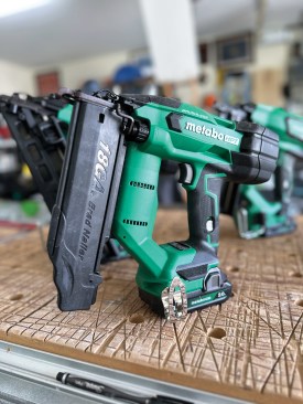

MultiVolt 18-Gauge Brad Nailer. Metabo says that its new and improved 18-gauge brad nailer (NT1850DF) is 30% smaller and 31% lighter than its previous model. Now weighing only 4.4 pounds (without a battery), it still has the same 100-nail magazine capacity that handles 5/8-inch to 2-inch brads, and keeps other great features, such as the LED light, from the first generation. That 31% weight reduction is a very big improvement, especially for overhead work, resulting in a lot less fatigue. The belt clip on this gun comes with the kit and can be installed with a supplied Phillips-head screw.
Metabo HPT’s 18-gauge brad nailer (NT1850DF) is smaller and lighter than previous versions, and now has an on-board battery gauge. The 100-nail magazine can handle 5/8-inch to 2-inch long brads.
This versatile brad nailer can shoot 1,300 fasteners per charge when fitted with a 2.0-Ah battery, which lasted up to a whole workday for me, depending on the project. Because of the small holes it makes, this is the nailer I reach for the most out of all the gauges for fastening trim work, with the exception of interior door jambs. When additional holding power is required, I will switch to a 15-gauge or 16-gauge nailer. Suggested retail price: $280.

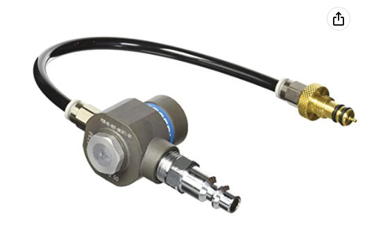

One thing to be aware of with all three of these nail guns is that the tiny compressed air cylinders that power their firing pins—Metabo HPT calls it an air spring drive system—might occasionally need to be recharged. While you can send the tool back to the company for recharging, you can also purchase a $65 adapter and do this yourself. Considering that the adapter consists of two pieces of brass and a short rubber hose, it’s not exactly a cheap fix, but by attaching the adapter to the gun and a regular compressor, you can quickly return the gun to full pressure.
A reduction valve set (available on Amazon; Hitachi 371208 J-394) that attaches to an air compressor is available for refilling the air chamber that powers the firing pins of the Metabo HPT's 15-, 16-, and 18-gauge cordless nailers.

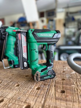

MultiVolt Brushless 23-Gauge Pin Nailer. This compact nailer (Model NP18DSALT) has a different firing mechanism that left me with mixed feelings. Looking at the spec sheet, I’d say it has great features, such as the ability to fire 3,000 nails per charge, a weight of only 3.3 pounds, and an LED work light, making it convenient to use. But when I fired the gun, each shot had a weird vibration that was very different from what I felt with its larger siblings, due in part to the spring and cam internal action versus the compressed canisters used in the larger-model nailers.
Metabo HPT’s 23-gauge pinner (NP18DSALT) has a spring and cam internal firing mechanism versus the compressed canisters used in the company's larger-model nailers.
When using a 23-gauge pinner, I am typically nailing stain-grade moldings or delicate pieces, and with this nailer’s recoil, I struggled to get it to perform like a pneumatic. The gun size and features are great, but I would love to see some improvement in its overall performance before I got another. Suggested retail price: $230.

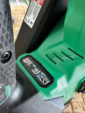

New battery. If you’ve ever used the original Metabo HPT nailers, you may have been frustrated by the lack of battery gauges on the batteries and by the slightly confusing gauges on the guns that weren’t convenient to use. While the gauge remains on the guns, Metabo HPT’s new batteries—including the 2.0-Ah batteries that come with these kits—now have a traditional-style four-block battery gauge that is clear to see and easy to operate.
The on-board battery gauges on Metabo HPT’s 18-gauge brad nailer and 23-gauge pinner aren't as intuitive as the simple four-block gauges that are now included on the company's batteries.
