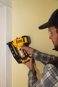

The arrival of Dewalt’s newly updated 16-gauge XR finish nailer could not have come at better time. My co-worker, Bruce Cranston, and I were just one week into a two-month-long interior trim job, giving us the perfect opportunity to put the gun to work. After trying several other styles of cordless trim guns that required gas cartridges over the years, we were excited to try out a fully battery-powered gun that boasts some impressive features.
Performs like a pneumatic

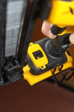

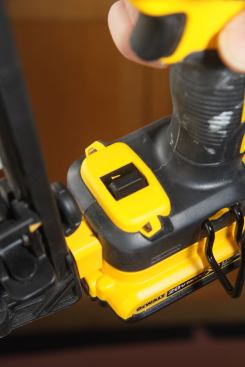

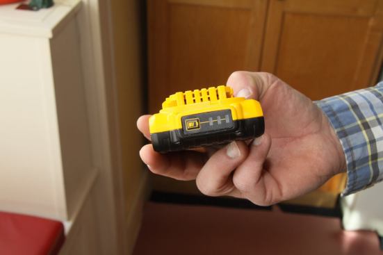

After two months of consistent use and thousands of nails later, we were very happy with how the gun performed. We had no trouble with lack of power coming from the 20-volt lithium ion battery. The gun was able to drive and set nails effortlessly into pine and poplar trim while it was less consistent in setting nails in harder trim like oak. According to the specs, with a fully charged 2Ah battery you can shoot up to 800nails. Although we didn’t keep count, that number seems completely realistic. DeWalt only supplies one battery with this gun, so you need to incorporate charge time into your work schedule. Two batteries would be very helpful especially if you’re going to use this as your main finish nailer. One nice feature on the supplied battery is the gauge; battery level indicator at the press of a button.
We had no problems with jams and misfires when shooting through softer woods and poplar. The gun did jam while firing into oak on a few occasions. But the tool-free jam clearing is fast and easy to use, so these jams didn’t slow us down noticeably. Coming in a 6 lbs, it’s not light, but the ergonomically designed handle and the tool’s balance makes using the gun seem easy and lighter than it really is. The design also allows you to stand the gun up on the battery or its face when you set it down so it’s convenient to grab quickly and keep moving.

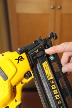

The gun is easy to load, and holds up to 110 nails at a time. One thing we found disappointing is that the gun will continue to fire even when empty. Unlike pneumatics that will do the same, this cordless nailer doesn’t make a different noise when firing empty. There’s good visibility through openings in the magazine, however, so if you keep an eye on the nails as you work you can train yourself to overcome this minor annoyance.

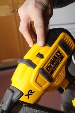

Changing nail depth can easily be done with a turn of a dial, and we particularly liked the depth gauge that is provided. The depth gauge gives you a clear indication of the depth setting so every adjustment can be monitored easily.
The sequential and bump modes allow for fast and precise nailing, and made using the gun feel very similar to using a pneumatic. Both features are perhaps the most surprising and appreciated features. Most battery-powered nailers have a recovery time after each nail fired, but this gun plays like a pneumatic in that respect. The bump mode is fantastic for tasks like running baseboard, though we found it only made us miss the lack of an “empty” lock-out feature even more. You can run a hundred feet of baseboard without taking your finger off the trigger, but you’ll never know you ran out of nails. The belt clip and work light is also very helpful. Unlike most work lights on tools these days, DeWalt created a headlight-like style that illuminates the area around where you’re working – not just a spot light right over the nail.
