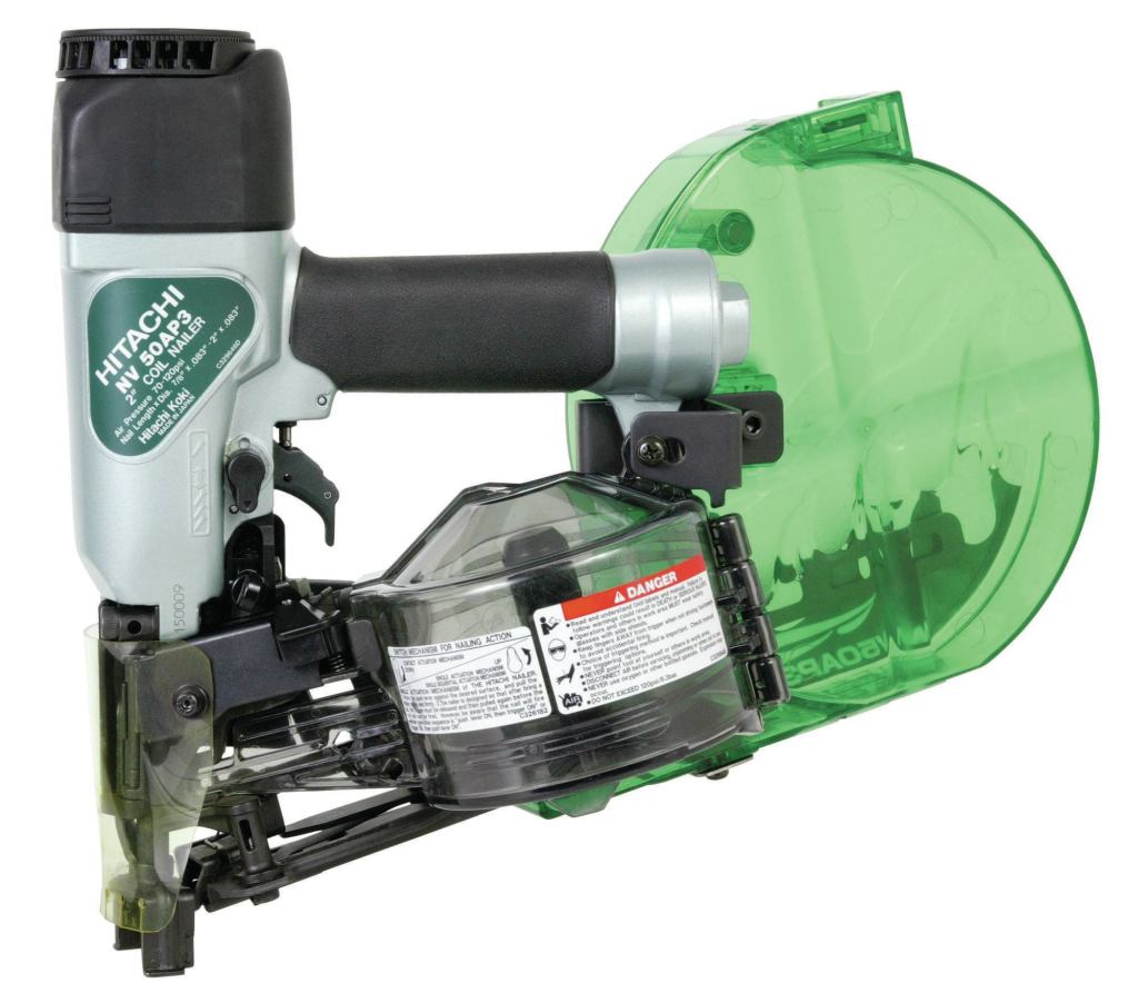

We switched to hand-driven plastic-cap nails a few years ago to comply with the new manufacturer recommendations. The fasteners work well, but only a small number can fit into a nail bag, and hand-nailing is awkward and slow. Hoping to dramatically speed up the work, we bought a pneumatic Hitachi NV50AP3 coil cap nailer. That was almost a year ago, and so far, we’ve been happy with that decision.
NARROWING THE FIELD
We initially considered buying a pneumatic cap stapler, but quickly switched our focus to cap nailers because nails are more dependable in high winds and are approved by more synthetic-roofing underlayment manufacturers. Also, the most powerful cap-nailer models can drive longer fasteners.
Based on my research, we shortened the list to two options: the Bostitch N66BC and the Hitachi NV50AP3. The Bostitch can drive cap nails up to 2 ½ inches long, so it can be used to attach 2-inch-thick foam. It holds 300 coiled nails, but only one cylinder of 100 string-collated plastic caps, which means you have to reload the caps three times per nail coil.
The Hitachi, on the other hand, drives cap nails up to only 2 inches long but conveniently holds 350 coiled nails and a matching reel of 350 plastic or metal caps. Also, we’ve owned more than 20 Hitachi nailers during the past 13 years with almost no complaints, and the NV50AP3 is a third-generation model that has been on the market since 2005. Although the Hitachi cost about $180 more than the Bostitch, we bought the Hitachi.
THE VERDICT

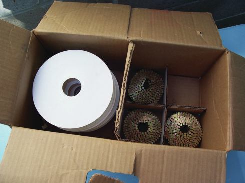

We’ve used the NV50AP3 to install Tyvek HomeWrap, ¼-inch fan-fold foam, #30 roofing felt, and RhinoRoof synthetic roofing underlayment—driving more than 30,000 1 ¼-inch-long plastic-cap nails. Hitachi sells them by the case for about $52, packing 2,800 caps and nails into a sturdy cardboard box with dividers that keep the rolls from uncoiling.
I’d estimate that using the tool is at least five times faster than hand-nailing. Once we dial in the driving depth, the NV50AP3 consistently sets nails to the desired depth even in foam, which is hard to do when hand-nailing. Although we’ve used the tool in temperatures down to 15°F, it has misfired only occasionally—when a cap hadn’t completely severed from the roll. It was easy to clear the problem and get back to work.

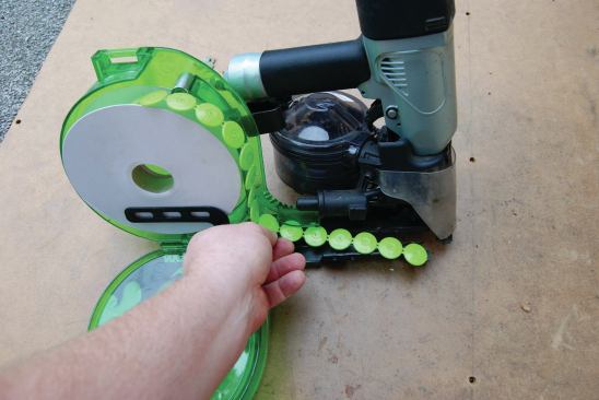

As advertised, the tool is well-balanced and feels lightweight. The cap magazine is bulky but doesn’t prevent us from nailing into tight spots. The cap and nail magazines are both easy to load one-handed while we’re working out of a nail apron on a roof or ladder, holding the tool with the other hand. We also appreciate the translucent magazine covers, which let us check the contents at a glance. You can easily adjust the exhaust vent so it doesn’t blow air in your face, and a simple switch toggles between bump and sequential firing.
On the downside, the tool doesn’t have a rafter or belt hook, and you have to install your own 3/8-inch NPT male plug at the air inlet. But overall, Hitachi’s cap nailer has been a great tool that’s paying its way in labor savings.
