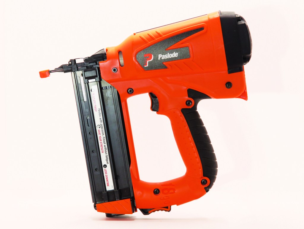

Here's a look at how the Paslode gas / battery-powered brad nailer fared when compared with all other cordless brad nailers on the market.
Paslode IM200Li
Comments: This is a very light and well-balanced gun with a comfortable grip. The body design allows comfortable use at a multitude of angles for several hours without fatigue. The small front housing works well in small spaces and corners. This gun jammed once when low on fuel; no tools are required to clear jams, so getting back on track was quick and easy. As with all gas-fired guns tested, there is no bump mode. It has very good line of sight with an excellent no-mar tip. Gas cartridges are easily changed and a rechargeable battery is included. This nailer can shoot up to 1,000 nails per gas canister. The 4V li-ion battery will last up to 12,000 shots per charge. It has consistent power to drive nails through hardwoods.
PROS: weighted and balanced such that it can be used for extended lengths of time; minimal marring and small hole size; belt clip can be spun to hang on a ladder
CONS: misfires on low fuel; emits a strong odor; need to disengage battery to minimize drainage when not in use
