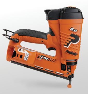

As a finish carpenter, I have long relied on Paslode cordless finish nailers for trim work. They’re bulkier than pneumatic guns, but I consider that a small price to pay for the quick setup and maneuverability that comes from working without a hose or compressor.
Paslode recently released the IM250A Li, an upgraded version of its 16-gauge angle nailer. Like previous models, it’s powered by an onboard fuel canister and battery. But the battery is a 7.4-volt lithium-ion pack instead of a 6-volt nicad, and the manufacturer has tweaked or upgraded a number of features.
I’ve had this tool for several months and have used it on everything from door casings and wainscoting to built-ins and baseboard. Here’s what I can tell you about it.

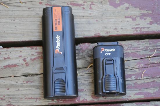

The li-ion battery is much smaller and lighter than the nicad. This makes for greater maneuverability and a more balanced feel. Because Paslode puts its battery cartridge along the side of the magazine, the smaller li-ion also gives you a better line of sight to the tip.
One of my favorite changes is the addition of a second position to the battery compartment. With earlier models the battery was either in or out, and when it was in, it was slowly losing its charge — even when you weren’t firing nails. Now I can pull the battery back to the second position to prevent it from draining overnight or whenever I put the tool down for an extended period of time.
According to the manufacturer, a fully charged li-ion battery is capable of firing 6,000 nails (vs. 4,000 for the nicad); if you deplete it, two minutes of charging will get you enough juice for another 200 fasteners. I used this gun on nail-intensive projects, such as installing beadboard, and never had issues with runtime.

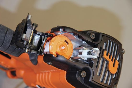

Paslode has improved the depth-of-drive mechanism: It operates more smoothly, and the thumb-wheel is larger than it used to be, making it easier to turn with gloves on.

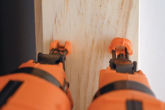

The contact tip has been reversed so it’s open on top, which provides a much clearer view of the nailing area. This is a great improvement because you can place nails with more confidence and accuracy when you don’t have to peer around the tip.
