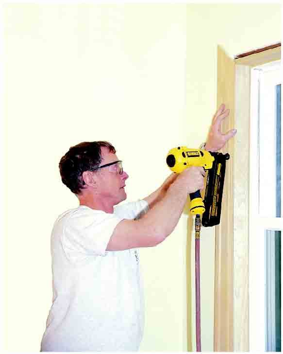

A finish gun is at the heart of any trim carpenter’s tool kit. Production carpenters may favor 16-gauge tools because the fasteners are cheaper. But as a custom finish carpenter, I’ve always preferred 15-gauge guns because the thicker nails hold better and are less likely to bend. And because 15-gauge fasteners are collated at an angle, the guns work better in tight spaces. For this article I tried out nine different 15-gauge angle nailers. Some of them have been around for years, but a few are brand new.

It’s hard to choose a favorite 15-gauge nailer because there are so many good ones out there. If I had to buy one tomorrow, I’d probably go for DeWalt or Hitachi. But you wouldn’t have to twist my arm to get me to consider Bostitch or Max. All four guns have power to spare.
DeWalt’s D51275 is one of my favorites because it’s powerful, extremely light, and equipped with well-conceived features like a belt hook, indexed depth-of-drive, and a tip that doesn’t block your view. I like the Hitachi NT65MA because it’s a lighter-than-average gun with a comfortable padded grip and a very cool built-in blow gun. The Bostitch N62FN is extremely powerful and is the lightest 15-gauge nailer you can buy. It’s sleek and uncluttered and is one of only two guns that doesn’t need oil. Max’s NF550 is a well-made tool with superior features like a trigger lock, a large depth-of-drive wheel, and an anti-double-fire mechanism.
