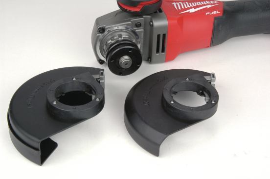

  • Each tool comes with an open-bottom (Type 27) grinder guard, but models that also include an enclosed-bottom (Type 1) cut-off-wheel guard add to their utility and safety while cutting.

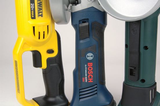

  • Grinders with lock-on switches allow more freedom of movement and create less fatigue than those with a paddle switch or trigger that must be held on.
  • The grinders that fit 5-inch wheels allow you to use longer-lasting cut-off wheels, however, the extra torque required for grinding with a larger wheel may sap the tool’s strength.
  • Grinders with motor brakes increase productivity because you can set the tool down immediately after use, instead of waiting for the wheel to stop.
  • While it was hard to detect the exact benefit in use, two of the top models feature high-tech brushless motors with electronic instead of brushed commutation designed for high-efficiency operation.

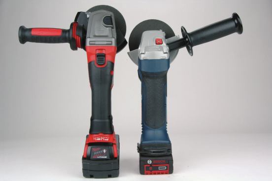

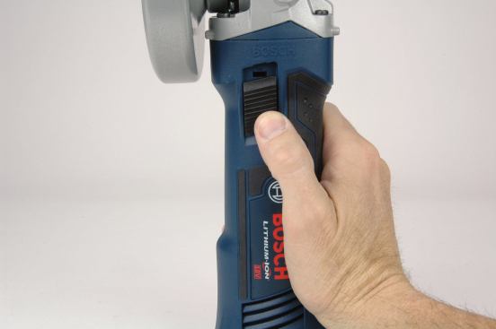

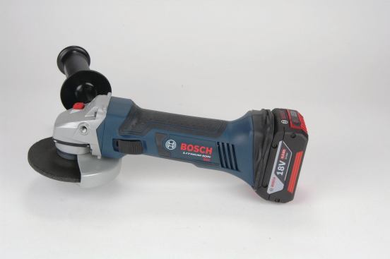

Bosch CAG180-01
Battery: 18 volts, 4.0 Ah
Battery gauge: 3 bars, on battery
Weight: 5.1 pounds
RPM: 10,000
Switch type: lock-on slider switch
Guard: 4 1/2-inch grinder guard, 4 1/2-inch cut-off wheel guard
Guard adjustment: requires hex wrench (stored onboard tool)
Web price: kit $399; bare tool $125
Includes: tool, 2 batteries, charger, cut-off guard, wheel wrench, fabric duffel bag
Country of origin: tool: Germany; battery: Malaysia
Comments: Solid third-place tool with great runtime and a light, agile form, but it slows under load more than the top two.
Pros: Separate grinder and cut-off guards; small switch positioned to the side keeps it well out of the way; slender body easy to grip.
Cons: A hex wrench is required to adjust the guard, which slows down the process.

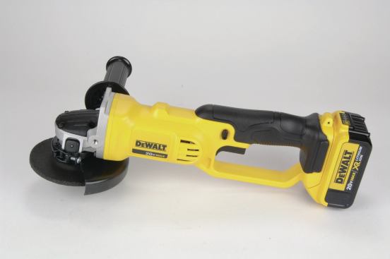

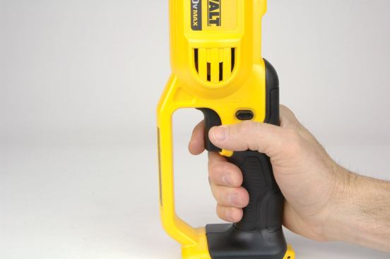

DeWalt DCG412M2
Weight: 6.3 pounds
RPM: 7,000
Switch type: trigger
Guard: 5-inch grinder guard, 5-inch cutoff wheel guard
Guard adjustment: tool free
Web price: kit $299; bare tool $119
Includes: tool, 2 batteries, charger, cut-off guard, wrench, fabric duffel bag
Country of origin: tool: Mexico; battery: Japan
Comments: A strong tool that gets extra torque from its slower motor, but its bulky rear handle with a trigger is not preferred over a standard grinder design.
Pros: Separate grinder and cut-off guards; 5-inch guards lets tool fit wider range of wheels.
Cons: Biggest and heaviest; bulky handle design; having to hold on to trigger adds fatigue and diminishes grip versatility; grip with handle way at the back makes it cumbersome, especially when following curves.

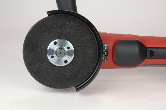

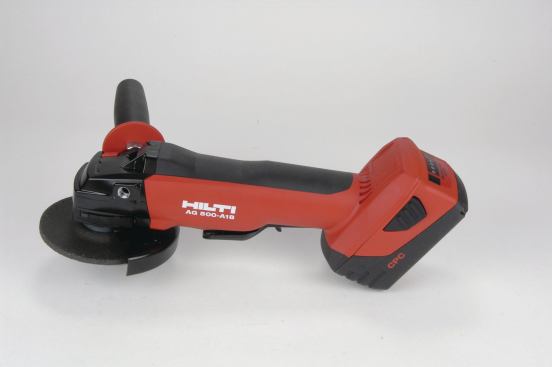

Hilti AG 500-A18
Battery: 21.6 volts, 3.3 Ah
Battery gauge: 4 bars, on battery
Weight: 6.1 pounds
RPM: 9,500
Switch type: paddle switch

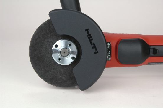

Guard: 5-inch grinder guard, plastic cover for cut-off use
Other features: tool-free wheel nut; brushless motor, metric M14 shaft
Web price: kit $559; bare tool $329 (manufacturer’s list price)
Includes: tool, 2 batteries, charger, cut-off guard cover, wrench, 25 cut-off wheels, fabric duffel bag
Country of origin: tool: China; battery: China
Comments: This fast cutter shares third place, but it’s at its best when applied in short intervals; when pushed hard for very long its speed wavers under load.
Pros: Fast motor brake; cut-off guard cover plate snaps onto grinder guard without tools; 5-inch guard let tool fit wider range of wheels; nice wrench-free wheel nut can save time
Cons: Once motor speed dipped under load, it took a while with the pressure let up before the brushless motor found the top of its range again; this characteristic seemed to slow output more noticeably during longer periods of use; paddle switch only—would prefer a sliding switch.

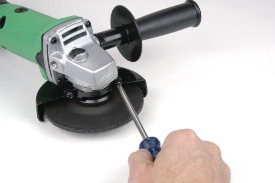

Guard adjustment: requires screwdriver (not included)

Comments: Light-duty tool with only modest power and runtime; outclassed by other tools in the test but its compact form was appreciated for lighter finishing work.
Pros: Light weight, good balance, and lots of rubber grip surfaces made this downsized tool a standout for one-handed finishing work.
Cons: Limited to light work; screwdriver is required to adjust the guard which slows down the process; unlike the others with multiple LEDs on the battery, has a more rudimentary fuel gauge with two LEDs on the tool itself; lacks cut-off guard.

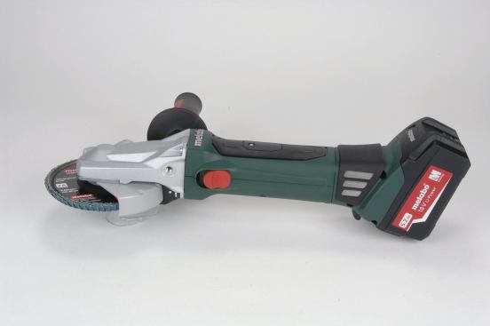

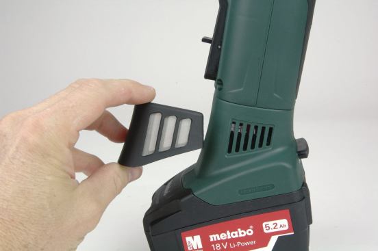

Metabo WP18LTX115
Battery: 18 volts, 5.2 Ah
Weight: 5.5 pounds
RPM:8,000

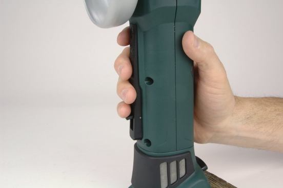

Switch type: paddle switch (lock-on slider switch model also available)

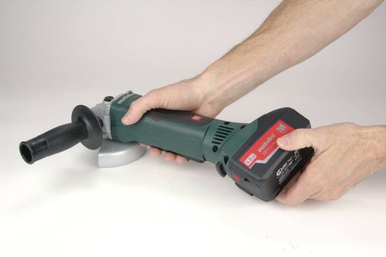

Other features: rotating battery, removable filter screen, overload warning light
Web price: kit $399; bare tool $103.
Includes: tool, 2 batteries, charger, wrench, plastic case
Country of origin: tool: China; battery: Hungary
Comments: Firsts in every test really says it all; hands-down the best tool for serious cutting and grinding with powerful and predictable performance.
Pros: Unique rotating battery lets you optimize the tool’s form and balance for different grinding and cutting positions; filter screen a nice extra for protecting the motor.
Cons: Would rather have the sliding-switch version (W18LTX115) rather than the paddle-switch version for ease of use; lacks cut-off guard.

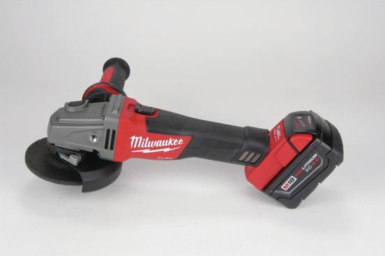

Milwaukee Fuel M18 Brushless
Weight: 6.0 pounds
RPM: 8,500
Switch type: lock-on slider switch (paddle switch model also available)
Guard: 5-inch grinder guard, 5-inch cut-off wheel guard
Other features: rubber bushing in handle, removable filter screen, brushless motor
Web price: kit $399; bare tool $169.
Includes: tool, 2 batteries, charger, cutoff guard, wrench, spare filter, plastic case
Country of origin: tool: China; battery: Korea and China
Comments: Strong, smooth second-place tool. A real comfort standout. Comes with useful accessories and extras.
Pros: Fast motor brake; separate grinder and cut-off guards; 5-inch guards let tool fit wide range of wheels; rubber bushings on front handle and slender, rubber-covered rear handle provide a great feel in use; wheel nut can be removed without a wrench; filter screen protects motor.
Cons: Extra length can reduce maneuverability in some uses.

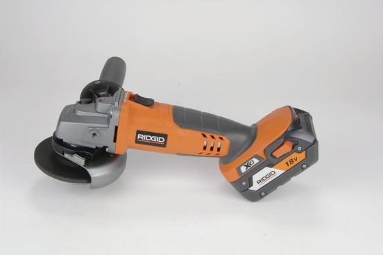

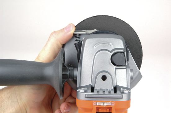

Ridgid R86040B
Weight: 5.5 pounds
RPM: 9,000
Other features: overload warning light on tool, three-position handle
Web price: bare tool $99
Includes: tool, wrench
Comments: Light-duty tool that stalls quickly and frequently under load due to its overprotective battery feedback circuit. This characteristic makes it frustrating to use and limits the tool to timid grinding and cutting uses only.
Pros: Balanced compact tool, but heavy.
Cons: Hair-trigger protective circuit shuts off tool before user feels or hears it slow; two distracting LEDs on tool caution the user to ease up, but they go on almost constantly; the limited amount of pressure you can apply to stay below the warning threshold is much less than with the other tools; lacks cut-off guard.

The Metabo takes the top spot, as it won every single power, speed, and runtime test. It also has advanced features. In the No. 2 spot is the Milwaukee, with a great combination of power when it counts the most and many advanced features. Great performances by Bosch and Hilti have them sharing third, and the powerful yet clumsy DeWalt follows. The light-duty Hitachi was a comfort standout, especially for finish work, but is really not in the same class as the more powerful tools above. The Ridgid trailed behind all with its timid output, doomed by a load limiter set too far below the level of work a cordless grinder needs to do.

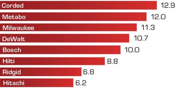

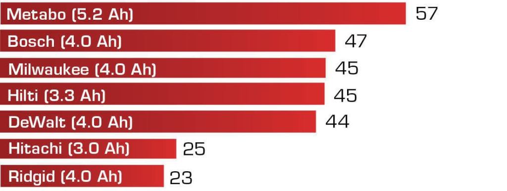

Runtime
Number of cuts through 1/2-inch rebar on a fully charged battery. Tested with Norton RightCut Type 1 cut-off wheels, .040-inch thick.

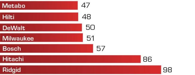

Cutting Speed
Time in seconds to make 10 cuts non-stop through 1/2-inch rebar on a fully charged battery. Tested with Norton RightCut Type 1 cut-off wheels, .040-inch thick.
