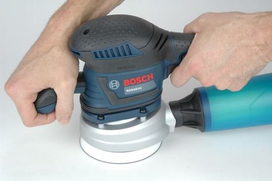

Bosch ROS65VC-5

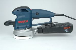

Bosch 3725DEVS

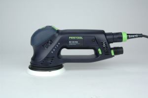

Festool Rotex RO125 FEQ

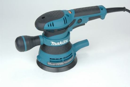

Makita BO5041K

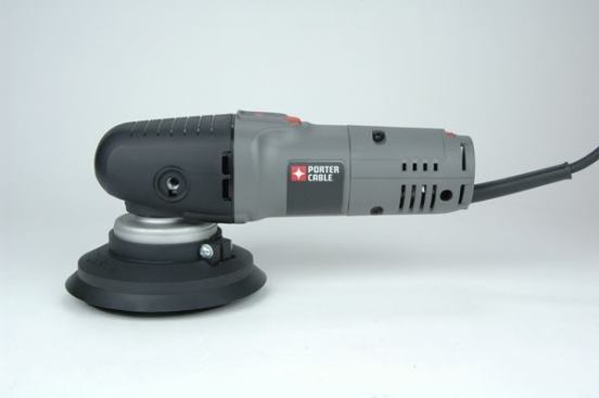

Porter Cable 97455

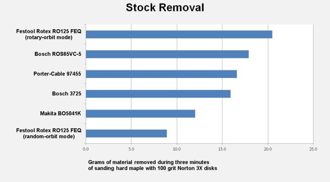

I tested each tool to determine which removed stock the fastest.
The Festool sander has two modes and was tested in each. The amount of stock removed was determined by weighing boards on an electronic scale before and after sanding. The amount of weight lost is the amount of material removed.

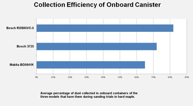

All of the tools can be connected by hose to dust collecting vacuums. Both Bosch models and the Makita come with onboard containers for collecting dust. Onboard collection is not as efficient as using a vacuum but is better than using nothing. Collection efficiency was determined by weighing boards and canisters before and after sanding. If all of the weight lost by a board was gained by the canister, then the sander would be 100% efficient. No sander came close to that but the top performer (see chart below) did not do badly.

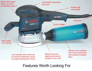

The benefit of rear-handle sanders (more accurately, dual-handle sanders) is illustrated in this photo of the Bosch ROS65VC-5 in hand. It’s easier to apply a balanced downward force on the tool with both hands rather than just one. It is also less fatiguing to the user during long sanding sessions and provides much greater steering control on uneven surfaces. For a detailed review of this model see Bosch ROS65VC-5.
In the event you need to sand into a corner up against a vertical surface, the front handles of all three dual-handle models detach easily. For a detailed review of this model see Bosch 3725DEVS.
The Festool RO125FEQ Rotex model is a random-orbit sander with a secondary mode for more aggressive sanding that the other tools don’t have. For a detailed review of this model see Festool RO125 FEQ.
As the smallest and lightest tool in the group, the Makita BO5041 isn’t quite a full-size dual-handle sander like the Bosch models. Rather, it’s more of a hybrid that shares the body size and shape of a palm-grip sander, but with a rear handle added on. With the front handle unscrewed, this versatile tool offers all the maneuverable grips of a one-handed sander. And with the front handle on, it offers all the stability and control of dual-handle models. For a detailed review of this model see Makita BO5041.
A large, geared-down motor is typical of right-angle sanders such as on this Porter-Cable 97455. Lower speeds and high torque typically make a model like this better suited for faster and rougher sanding or for buffing and polishing uses. For a detailed review of this model see Porter-Cable 97455.
