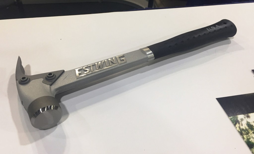

Estwing AL-Pro Hammer
Best known for its single-piece steel hammers Estwing is about to introduce the AL-Pro, a multi-piece hammer with a steel claw and striking face attached to a single-piece aluminum head and handle. The head is hollow and contains shot to dampen vibration and provide a dead blow. The hammer has a magnetic nail starter and like most other Estwings, a thick nylon-rubber grip to eliminate shock.
In the past, framers used 22-28-ounce hammers and paid the price with arm and shoulder problems. The current thinking is that lighter is better and what light hammers lack in driving force can be made up for by using a faster swing—which is why AL-Pro framing hammers weigh only 14 ounces. Stiletto popularized this idea with its titanium hammers. Estwing went with aluminum because it’s lighter and easier to work with, and not subject to the patents Stiletto holds on titanium.
The AL-Pro is intended to compete with premium hammers such as those from Stiletto. Available with a smooth or milled face, it will sell for about $130 and is expected to hit store shelves by the end of the year.
An interesting side note: the AL-Pro is produced at the Estwing factory in Rockford, Illinois using aluminum castings supplied by an American company that makes receivers for AR 15s. Demand for those rifles has been high so Estwing had a tough time getting the necessary castings.

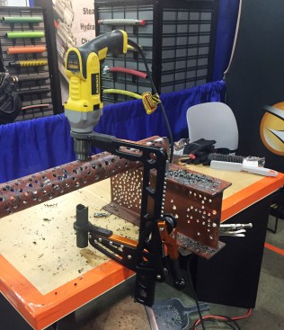

Rapidrill
The Rapidrill is an accessory that allows a corded or cordless drill to be used in place of a magnetic drill. It’s an adjustable frame that resembles a large f-clamp. The drill of your choice can be attached to one end while the other is used to back the beam, pipe, or angle being drilled. A lever and gears provide pressure while drilling—pushing the bit into the work with far less effort than drilling by hand. If you’ve ever drilled metal overhead or made multiple holes in thick metal with a hand-held drill you’ll know why I think this is a cool product.
There are two versions of the device. The $1,200 industrial model (Rapidrill Pro) is not any cheaper than a cordless mag drill, though I am told by the manufacturer it will fit places a mag drill will not, and work on material that won’t hold a heavy machine. The commercial model (Rapidrill Slim) is smaller and less capable than the industrial version, but at $399, a far more affordable option.

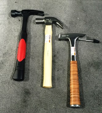

The hammers above are made by Picard and show how hammers differ from country to country. On the left is an American pattern hammer, which can be distinguished by the tapered neck between the striking face and head. Next is an English pattern hammer, which except for the lack of a taper is the same as an American hammer. On the right is a German Latthammer, which has a square face for nailing into corners and an elongated claw on one side—which is used for chipping and occasionally for punching slate. I understand why German framers use Latthammers; German homes are usually masonry and most framing is on roofs, where one might encounter slate. The difference between American and English hammers (or the difference between any hammer and the ones used in Japan) is harder to explain. I suspect that at some level it’s simply a matter of style and tradition.

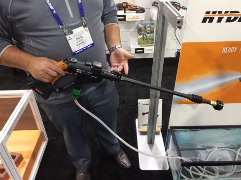

Worx HydroShot
I’m not usually impressed by tools from Worx (too DIY) but this one is kind of cool. The HydroShot is a 20-volt max tool that functions as a hand-held pressure washer. It has adjustable power and can spray water at 100-320 psi. That less than you’ll get from most pressure washer but then the average pressure washer is nowhere as portable as this 3.7-pound tool. It can be connected to a garden hose or used with a supplied plastic hose that will pull from a fresh water source such as a bucket, pond, or pool.
The manufacturer’s sell sheet shows it being used to wash boats, cars, and outdoor furniture—which is probably what most people will use it for. But I could see using one where a water line was not available to clean shovels, wheelbarrows, or the back of a truck or trailer after a trip to the dump. The existence of this tool makes me wonder what would happen if one of the big companies that make cordless OPE—DeWalt, Makita, or Milwaukee—came out with a similar tool capable of producing much higher spray pressure.
The HydroShot has an adjustable nozzle and comes with a suction hose, charger, and one 2.0 Ah battery. It is scheduled for release early next year and is expected to sell for about $120.

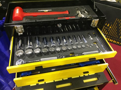

Tool Keepers Foam Inserts
You may have seen tool boxes outfitted with foam “shadow boards”, where there’s a cutout to fit each and every item that stores in the box. You can make them yourself or hire a company like Tool Keepers to do it for you. Tool Keepers uses a high pressure water jet to make foam inserts for customers such as Fedex, Lockheed, Amtrak, and the U.S. Military. The option exists to print the name/size of the tool in each recess and to laser etch a label onto each tool.
Companies typically send the box and tools to the Tool Keepers’ plant in Iowa, where a layout is created and approved prior to the foam being cut out. The finished box and tools are then sent back to the customer. I asked the guys at the Tool Keeper’s booth what it cost to have this done and was told it would be 10-15% of the cost of the tools themselves.
I can see how and why a big company might choose to do this but can’t picture a tradesman being willing or able to ship his tools and toolbox across the country. For those who would like to have this level of organization the more affordable option is to do the work yourself—by purchasing Kaizen Foam sheets or Kaizen Foam Inserts, which arrive cut to fit particular brands/models of tool boxes. Either way it’s to you to decide where tools go and to make the cutouts.
