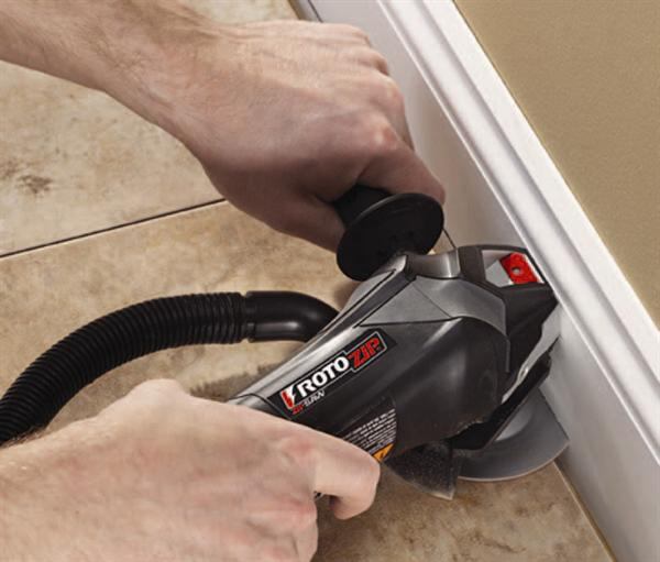

Versatile Cutoff Saw
The 7-amp RotoZip ZipSaw is a cross between a flush-cut saw and an angle grinder, and it accepts RotoZip wheels or standard 4-inch grinder wheels. You can use it for everything from cutting curved notches in tile to flush-cutting a door jamb to accommodate new flooring. The saw lists for $100 and includes a dust-collection kit and two wheels.
RotoZip, 877/768-6947, www.rotozip.com
