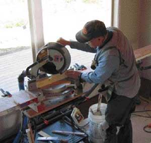

About 90% of the finish carpentry I do involves the miter saw, so it’s important to me to have a saw table that goes together quickly, serves as an efficient workstation, and then breaks down into small enough pieces for me to load in my van. You can buy a ready-made saw station, but it means settling for someone else’s design. I built my first saw table years ago and have been refining the design ever since. My current setup consists of a miter saw, portable table saw, shop vac, folding stands, and a customized duct system and extension tables.
At the core of this station is my DeWalt model 705 12-inch single-compound non-slide miter saw. This saw has the capacity to make all the cuts I need without the added weight, expense, and complications of a slider. The saw is supported by a Stanley WorkMate 400 (now 450). This sturdy, stable tool folds flat for transport and is able to resist all the turning stress of left/right mitering. The earlier generations of my workstation had homemade wooden stands that quickly became wobbly under the side-to-side stress of swinging the saw.
The saw is bolted to blocks that fit between dogs on the WorkMate’s top and are clamped in place by its vice. The blocks are sized to put the table at 38 inches, which is my favorite work height.

Table Saw
I use a 10-inch Makita table saw that’s equipped with an older PortaMax fence and table extension (Rousseau Co., 800/635-3416, www.rousseauco.com). This fence works better than the one that comes with the saw and gives me over 24 inches of rip capacity. A second WorkMate supports the table saw at the same 38-inch height as the miter saw. The saw is bolted to blocks that are grasped by the stand’s dogs and vise. Because the table saw is deeper than the miter saw, I leave the lower legs in the folded position. The upper part of the WorkMate is offset to the rear, so I face the saw backward in the stand so it won’t tip over when I rip.

The dust system is powered by a 16-gallon Craftsman shop vac. The filter has been removed and the exhaust is vented outdoors through a 2-inch ABS pipe. This probably affects the warranty, but a $100 vac lasts about two years and I can live with that. It is very satisfying to look out the window and see a big plume of dust far away from me. Aside from the health benefits, there’s a lot less cleanup when the dust goes outside.
Automatic switch. The heart of the setup is an automatic switch called the Automater (R.F. St. Louis Associates, 800/526-0602). It plugs into an electrical receptacle and the saws and vacuum plug into it. When you turn on a saw, the device sends power to the vacuum (the vac switch is always on) so it can transport the dust. To avoid tripping breakers, there’s a half-second delay between the start of the saw and the start of the vac. After the saw stops, the vac runs for a few more seconds to clear hoses. This setup may not be perfect for shop use, but it works pretty well on site and breaks down into small pieces to fit in my van.
Homemade air valve. To maximize suction, I rigged up a “valve” that prevents the vacuum from drawing from more than one machine at a time. There are ready-made products that do this, but they’re expensive and designed to be permanently installed in a shop. Mine is made from inexpensive parts you can get at the lumberyard. The body of the valve is an ABS 3×2 double-sani plumbing tee with a 2-inch reducer in the bottom. The vac hose connects to the reducer and the hoses to the saws connect to the sides of the tee. I take a short piece of 21/2-inch electrical conduit and slide it into the top of the tee until it bottoms out. Then I glue a short length of 3-inch ABS over the other end of the conduit and cap it off with a test plug. There’s a hole cut in one side of the conduit so if you twist it one way it connects one saw to the vac, and if you twist it the other way it connects the other saw.
