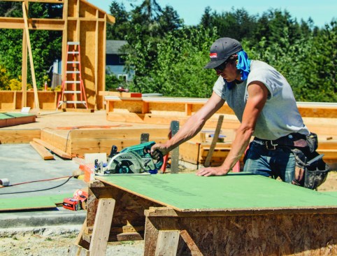

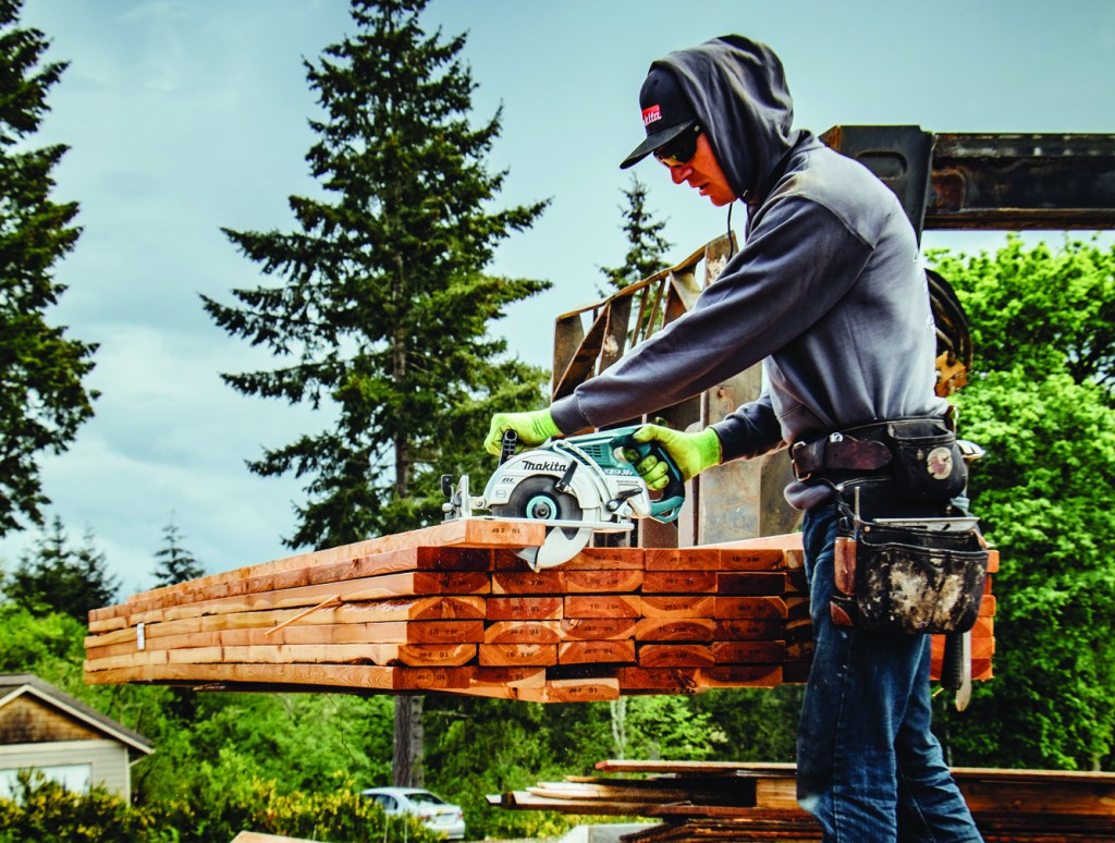

Pros of cordless on a wet site. According to Makita, its “Extreme Protection Technology (XPT)” improves dust and water resistance in harsh conditions by channeling water and dust away from the internal components. It seems to be working; using this tool in a way-aboveaverage wet spring didn’t present any difficulties for the author. And no cord means no tripped power.

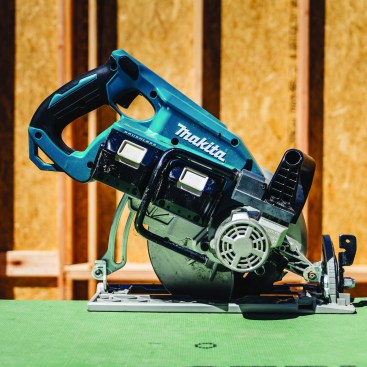

This Makita saw runs off two Makita 5.0-Ah batteries that are stored directly behind the brushless motor and under the top handle. This layout allows for the handle to be placed behind the motor, like on the saws we love out here in the West.

Rear handle means more reach. Like other rearhandle in-line saws, this cordless version allows for great reach while pushing through a cut. Because there’s no cord to nick, it also means a safer and more productive jobsite.

The brushless motor on this saw is crazy small, but it spins the blade at 5,100 rpm, a tad bit slower than the Skil at 5,300 rpm. I haven’t noticed the difference in use though. One feature of this motor is that it adjusts torque and cutting speed automatically. Apparently, this helps performance. If I pull the trigger with no load, I can hear the motor adjust speed when it enters the material.

Can this saw replace a corded saw for framers and concrete formers who need power to cut dense materials? The answer is, absolutely yes! I can’t count the number of times one of us has yelled in joy when making cuts in LVL or dry Doug fir 2×12. We started joking on the jobsite that the attention this saw was getting was going to make our wives jealous.
We haven’t found a situation where the Makita made us wish we had a corded saw rolled out; it has as much power as my four-year-old Skilsaw. I’ve ripped 3-foot pieces of 1 3/4-inch LVL to try and overheat it, to no avail. Ripping three layers of 7/16-inch OSB for roof sheathing didn’t present any problems either. I can get the saw to stop if the material starts binding, but I can also do that to every corded saw I’ve reviewed.
Small, brushless, and powerful. Dual 18V batteries sit just behind the motor; a built-in gauge shows their charge level. Despite its size, the motor yields plenty of power to compete with worm drives. A large rafter hook tucks out of the way when not in use.
