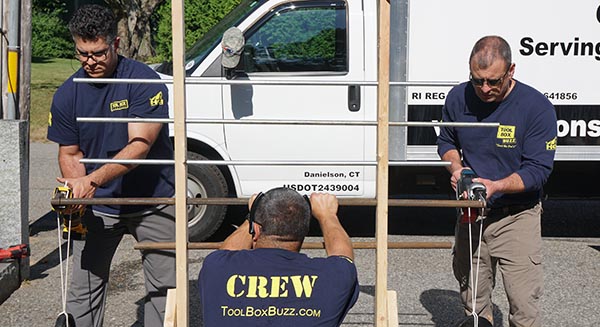

We did a number of speed tests in nail-embedded wood, EMT conduit, and gas pipe while gauging things like vibration and ergonomics. In an effort to obtain similar cutting pressure applied to each saw, we hung a 10-pound weight from a rope on each saw.
