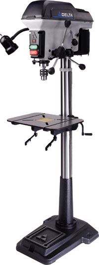

These machines are large and heavy, and require two people to assemble safely. It took us about 45 minutes to assemble the 238-pound Delta. The instructions are not written clearly, and in several instances, the pictures are incorrect or omitted completely. Therefore, this product required more problem-solving and drill press familiarity to assemble.

Heavy cast iron bases are standard on drill presses, but manufacturers of both tools recommend you attach a piece of plywood to the base for stability if the tool is not bolted to the floor. The Delta base is sufficiently large and felt quite stable for the size of its head unit, but the Powermatic base is smaller and relatively lightweight for the machine’s size, making for a less stable feel.

Table and Fence. Both tools come with cast iron tables that are larger and more useful than the typical round design. Delta’s rectangular table has a relatively thin, flat profile that makes it easier to clamp on fences, jigs, stops, even the work piece itself.
The large, replaceable backer block allows for supported drilling through the center of the table, or the use of a drum sander below the level of the table. You can replace the block with any 3/4-inch thick material, and it has four set screw bolts with jam nuts underneath for precision leveling.
A major difference in the design for woodworking is the table trunnions that let it tilt forward as well as side to side. This comes in handy for drilling compound-angle holes for chair seat spindles without building any jigs.

Laser Guides. Both drill presses have cross-plane line lasers that provide a cross hair on target with the center of the bit, regardless of the height of the table. This is easier and faster than the typical method of repeatedly stabbing at the work to find the mark. Delta’s lasers are in a bolt-on unit that sticks out into the work zone, and its placement seems more likely to invite misalignment or damage with unwanted bumps.

Both laser units required calibration before use, but only Delta provides a handy calibrating pin with a printed line that you train the lasers on while it is chucked in. Powermatic requires you to make your own calibrating device by drawing a line on a board.
Worklights. We like Delta’s externally attached, flexible lamp, which has better adjustability and brighter light, even though it takes an odd-size bulb that is not provided. Powermatic has built-in LED lamps. These have much longer life but limited brightness and adjustability.
Chucks. Delta includes a traditional 5/8-inch keyed chuck, and Powermatic has a 5/8-inch keyless chuck–a new twist for us. In our test, each chuck demonstrated +/- 0.003-inch of deflection, measured throughout the stroke.
Operation. Speaking of the stroke, a short stroke length has been a constant shortcoming of drill presses. These new designs address the need for the deeper holes of woodworking. Delta provides a 47/8 inch stroke, and Powermatic’s is 43/8 inches. For repeatable hole depths, Delta uses a fast, single-nut system; you push a button to disable the threads, and slide the nut over the threaded stop rod. Releasing the button engages the threads for fine tuning the adjustment.

Both units have multiple speed settings. Delta uses a manually adjustable belt and pulley system with 16 speeds from 215 to 2,720 rpm, which proved to be pleasantly quiet. Powermatic features an infinitely variable speed control via a lever on the side of its head. This mechanism changes the size of the pulleys with a simple push or pull, and while it is very quick, it also is very noisy. The rpm, between 400 and 3,000, is shown on a bright LED digital display that lets you dial in within about 3 rpm of your target speed.

The Delta was full of improvements that really make this a woodworker’s drill press. The compound tilting, clamp friendly table, and quiet operation really make it a standout machine, especially for its price.
