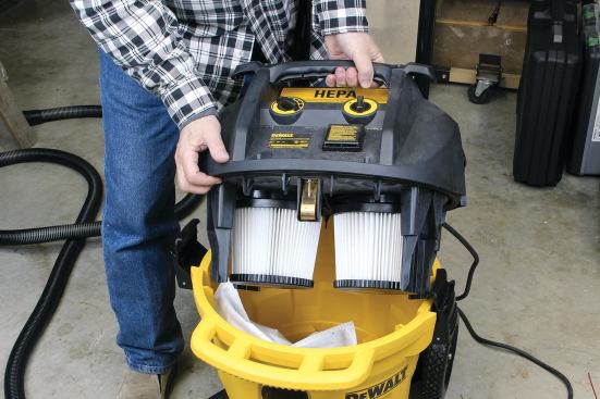

Testing the Machine
Not wanting to take the manufacturer’s word (or video) for what the machine can do, I repeated its test and performed a few of my own. In the tests, I collected wall texturing compound — chosen because it’s cheap ($9 for a 50-pound bag) and has very fine particles. The first couple of tests were not very challenging. I vacuumed about 40 pounds of texturing compound out of a drywall bucket, first with a paper collection bag in the machine and again with a fleece bag. When I opened the machine to remove them, it was clear they had captured virtually all of the dust. What little got through had been pulled against a filter, was knocked off during the automatic cleaning cycle, and then came to rest in the bottom of the tank.

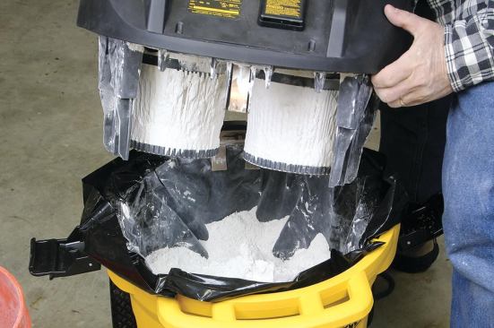

The next couple of tests were more challenging. In the first, I used a plastic collection bag. These open-top liners lie up and over the sides of the tank. They provide no filtering and are typically used to keep the tank clean while collecting slurry from wet cutting applications. I wanted to see if the plastic liner would remain in place (as it’s designed to do) or be sucked against the filters. The bag worked fine and the filter continued to draw while surrounded by plaster. The final test was a repeat of the manufacturer’s, suctioning up plaster with no bag at all. The results were the same as for the test before, only messier because there wasn’t a bag lining the tank.
According to DeWalt, it’s okay to operate the extractor without a bag. For this machine, bags exist to make it neater and easier to dispose of debris.
Self-Cleaning Mechanism
The filters didn’t clog when covered with plaster because the automatic cleaning mechanism blew them out at regular intervals. The auto-clean function works like this: Within three or four seconds of turning the vacuum on, you hear a muffled thump from inside the machine. A few seconds later you hear another one. The thumps are the sound of a solenoid closing a butterfly valve, reversing the flow of air through one of the filters and blowing it clean. It’s a quick blast of air and the valve reopens almost instantly. After this initial cleaning, the solenoids are activated at 30-second intervals, so each filter is cleaned every 60 seconds. Since filters are cleaned one at a time, one is always drawing, but suction is reduced by half during the instant when the valve is closed. I noticed a brief drop in suction when the vacuum thumped as I was picking up plaster. It was little more than a blip, and would not have affected the machine’s ability to collect dust from tools.

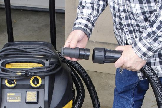

At the end of the hose is a twist-lock fitting that grabs onto the dust ports and shrouds of tools from DeWalt’s Perform and Protect line. The connection won’t come loose and the tool can be rotated without twisting the hose. Connectors are available to adapt the hose to older DeWalt models and other brands of tools. I like the positive connection between hose and tool, but the connector is kind of bulky and it’s not easy to determine which adapters fit which non-DeWalt tools.
