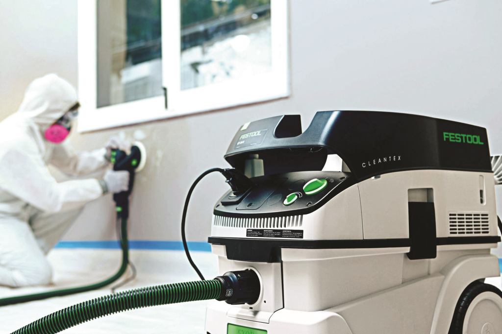

In placement order, the Festool and Metabo occupy the top tier, the Bosch and DeWalt the mid-tier, followed by the Fein and Makita.
It was difficult to pinpoint the best-performing vac in all aspects and trials, but I kept three things in mind when tallying the results. First, use on RRP jobs means these vacs will be used with a filter bag. Second, different-diameter hoses can be swapped easily for different tasks, which separates slow pickup issues that could be fixed with a different hose from issues that were real deal breakers. And third, in the context of using these HEPA vacs to collect and contain dangerous lead paint dust, filter effectiveness is of utmost importance.
The winning Festool was the only vac in the test that didn’t allow any captured dust to escape around its filter or anywhere else. In addition, the Festool has the largest filter-bag capacity and loaded its bag more evenly than most, which cut down on time spent dealing with the bag along the way. The availability of many different hoses and attachment kits from Festool makes for a particularly versatile vac system as well.
The other top performers were the Metabo, DeWalt, and Bosch. The Metabo is a solid unit that performed well in every way, and its filter-cleaning system that cycles only when needed proved effective and efficient.
