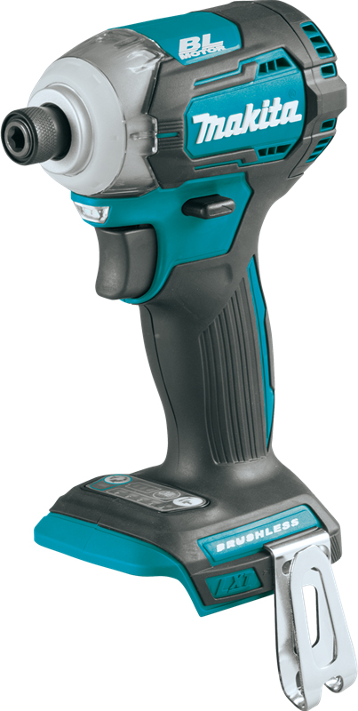

Say hello to the Makita XDT12Z 4-speed impact driver.
On the surface, this unit is a standard 1/4-inch hex drive built on Makita’s full-size 18-volt battery platform. Its brushless motor delivers up to 1,550-inch-pounds of torque in a surprisingly compact shell. The real genius here, however, is Quickshift. This feature—which I use all the time—takes advantage of the brushless motor’s control circuitry to provide a 4-speed “transmission” so to speak, with a couple of other nifty tricks up its sleeve.

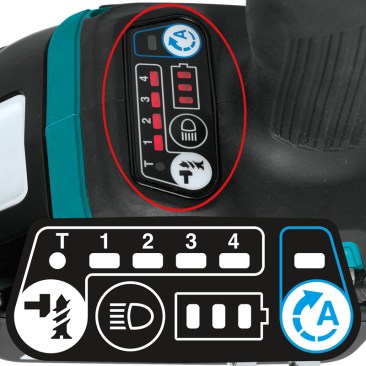

The base of the tool contains a small LED panel with three buttons. One LED bar shows battery charge level. The other displays the speed/power selection as well as what’s called T Mode. We’ll get to T Mode in a minute.
Pressing the power-adjustment button cycles you through the levels. For driving larger screws in framing applications like #10 x 3 or structural screws for roof framing (roof-framing tool review here by @AwesomeFramers) or deck ledgers or connections requiring maximum demand, Level 4 is the sweet spot. The driver delivers blistering speed and great torque, handling all but the largest structural fasteners you’re likely to encounter.

On the LED bar there’s an additional “T” for self-tapper mode.
If you’ve ever installed self-tapping sheet-metal screws, you know they require a high-speed start followed by a quick trigger release to set the screw without camming out the hole. I’ve done it plenty of times. In T Mode, there’s no guesswork or wasted time.
T Mode starts the driver at maximum rpm to pilot the hole. Then it senses the resistance change as the screw tip pierces the steel and quickly drops the rpm for cam out-free fastening over and over and over and over … you get it. No longer necessary: cat-like reflexes for multiple trigger pulls in a single, tiny fastener.
And while T Mode works well, there’s at least one limitation. It doesn’t function super well on thinner-gauge sheet metal (less than 30 ga or aluminum). It doesn’t seem to slow fast enough to avoid stripping. In medium- to heavy-gauge ductwork, I found the driver is sensitive enough to throttle back before camming the hole. In heavier-gauge metal—like the thousands of square feet of architectural metal siding and trim on a recent job—it performed reliably. For this heavier-gauge steel, I drove more than 3,500 1 ½-inch gasketed screws. In T Mode, it was an absolute dream. Pull the trigger, the screw screams as it pilots a hole. Then, abraca-brushless-dabra, the tool downshifts as the fastener threads into the sheathing, finally slowing down to a nice steady speed, enabling me to accurately set the gaskets just right.
Then there’s Auto Start; this feature is essentially the opposite of T Mode and is intended for large—longer than 3 inches or 5/16-inch or better diameter—structural screws. Pull the trigger, the unit starts spinning slowly. This allows you to accurately guide the start path of long fasteners—something kind of unruly at the tool’s maximum 3,800 rpm. As the fastener threads, the tool’s electronics sense increased resistance and deliver power and speed to match. This sends fasteners quickly to their final resting place while you move on to the next ones in line.
Hands down, this is my go-to driver. Out of all the options we have in the tool trailer or in the shop, it’s the one I reach for at the start of my day and is always within arm’s reach. The power, compact size, and ergonomics alone are enough to put it at the top of my list. Add its serious versatility and it’s a real darling.
I haven’t had the tool long, so I can’t speak to any kind of durability. However, I did own an early model released only in Japan. For more than three years, it has been absolutely punished with no ill effects whatsoever. I have little doubt this newer one will perform just as well.
Makita XDT12Z, get one.
