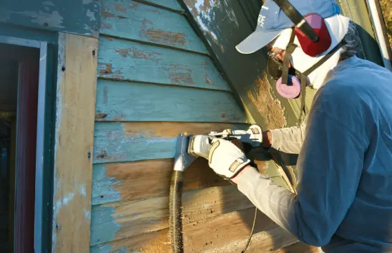

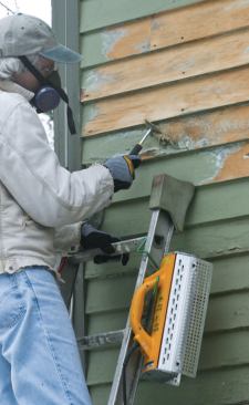

Having used a variety of paint-removal devices on many types of jobs over the years, I've found that most require two hands to operate safely and effectively. I prefer to stand on pump jacks or scaffolding when I work, which is what I did for most of the above-ground portions of this test. As an experiment, I also tried using each of the tools while standing on a short extension ladder.

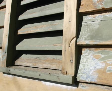

Based on a previous lead inspection, I knew that the clapboards and simpler trim surfaces on this house were lead-free, but many of the more elaborate trim elements (moldings, shakes, cornice) were not. Regardless of which surface I was stripping, I followed the same lead-safe procedures.
Personal protection. Even with tools that aren't supposed to generate dust, protective gear is a must. Throughout the test, I wore a HEPA-filtered (N100) respirator, safety glasses, and - when called for - ear protection. Disposable Tyvek coveralls are a great way to keep clothing uncontaminated, but they make me sweat like a pig. I prefer to wear old clothes (long pants, long sleeves) and cover my head with a spray sock.
When I'm done working I change clothes outside and wash the work duds separately.
Vacuum attachment. Contractors have been complaining for years about the lack of standard sizing for dust ports and vacuum hoses. Perhaps manufacturers have finally gotten the message - I had no problem attaching any of these tools to my vacuum. The dust ports for the Festool and Metabo were the same diameter (1 1/4 inches); the Paint Shaver used a different setup but came with its own 10-foot-long extension hose, which easily connected to the hose on my vacuum - no duct tape needed.
Nails. Protruding nail heads are not friendly to hand-scrapers, but what they can do to expensive high-speed carbide cutters is even worse. Although I tried to set all the nails within reach beforehand, I still didn't know what might be lurking beneath multiple paint layers, so I carried a hammer and punch at all times.
Testing. I put all the tools through an extensive workout, stripping paint off the siding and a variety of trim elements. Some surfaces had only a few layers of paint (similar to what you might find on a modern house), while others were thickly encrusted and alligatored.

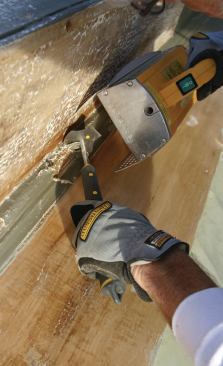

Paint Shaver Pro

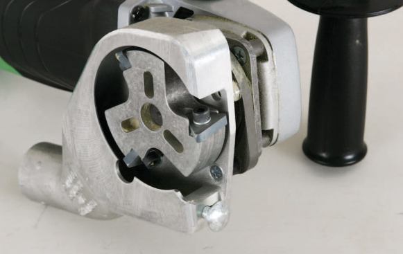

The Paint Shaver is essentially a modified mini-grinder. The model I received is powered by an 8-amp Hitachi G12SA3. A less-expensive 6-amp version of this tool is also available.
Instead of a simple abrasive wheel, the business end of this tool has a shaperlike cutter head outfitted with three triangular carbide blades. The cast-aluminum guard surrounding the blades controls depth-of- cut and provides an outlet for dust. A cutaway section in the guard allows the multisided blades to strip paint from the butts and faces of clapboards simultaneously.
New and improved. In an earlier version of this tool, dust was corralled by an enormous bristly shroud that encircled the cutter head. I'd used that tool a few times in the past and it worked fine, but the giant hooped skirt left me feeling like I was flying blind. I'm glad the manufacturer has figured out a way to channel dust removal through the guard instead. Also, even though the guts of the tool haven't changed, the new design feels lighter and easier to control.
Setup. The Paint Shaver has the skimpiest owner's manual I've ever seen - the entire document is printed on one side of a large sheet of copy paper - but the clearly written instructions are illustrated with good close-up photos, so it's easy to get the gist of the tool's operation. The blades come pre-installed and preset to a modest depth-of-cut; fine-tuning is accomplished with the turn of a screw.
Learning curve. This is an extremely powerful tool. Even though I'd had some previous experience, I had forgotten how easy it is to screw up and slice a divot. I quickly learned that the only way to achieve a smooth, paint-free surface is to adjust the tool for a shallow cut, gently sneak up on the painted surface, and make several passes. Safe operation requires two hands at all times. I did not feel safe when I tried to work off a ladder.
The redesigned guard housing can be rotated up to 90 degrees to get deep into corners - an improvement over the older model - but the tool still leaves behind a 2- to 3-inch arc of untouched paint that must be removed by other means.
While the dust collector seemed to suck up all the small particles, some larger chips managed to fly out through the cutout and hit me in the face. I started out wearing my prescription safety glasses with side shields, but eventually I smartened up and switched to goggles.

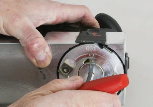

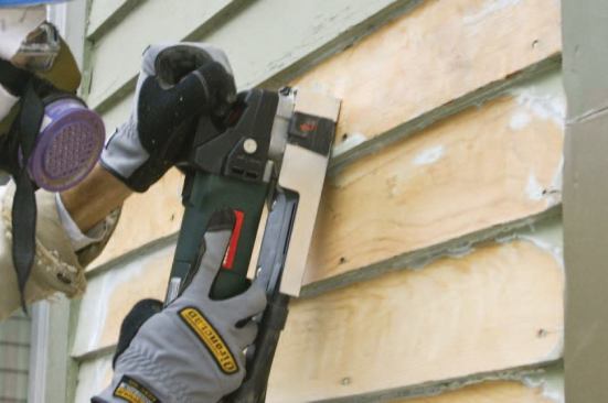

Metabo LF 724
The Metabo looks like the Paint Shaver's little brother. It's shaped like a mini-grinder and uses rotating carbide blades to remove the paint. But it's a much less aggressive performer.
Ease of operation. Whereas the Paint Shaver's three triangular blades use their pointed edges to chisel away the paint on the face of a board, the Metabo relies on a pair of flat-mounted blades that essentially plane off the unwanted coating. The planer analogy is appropriate because the rectangular blade guard features a 7 1/2-inch-long machined aluminum base. The manual says the tool should be operated as if it were a planer, keeping the base in contact with the painted surface and working backward from stripped to unstripped sections. This method worked fine when I was able to do it, but I found that the ideal direction of cut often depended on the grain of the wood - and going against the grain raised a lot of fur that had to be sanded down later.
Even when I deviated from the script, though, the quality of the work did not suffer. Removing paint with the Metabo took significantly longer than it did with the Paint Shaver. But it was less risky in terms of gouges and blemishes. And thanks to its compact footprint, the smaller tool also did a much better job in the corners. Dust collection was about the same as it was with the Paint Shaver.
Blade settings. Not wanting a repeat of my experience with the Paint Shaver, I set the blades for a shallow depth-of-cut at first, then gradually increased the setting until I found the sweet spot. For the work I was doing, the deepest setting (0.3 mm) worked best. To adjust the cutting depth you press a locking button and turn a dial with an Allen wrench.
Drawbacks. Like the Paint Shaver, the Metabo is outfitted with side cutting blades. These blades appear capable of stripping paint off the undersides of clapboards but in practice they are ineffective; their cutting depth is extremely shallow and there doesn't seem to be any way to adjust them. The owner's manual was no help in this regard. All of the tool's blades tended to gum up with old paint, but they were easy to clean using the miniature scratch awl included as part of the kit.

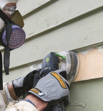

Festool RAS 115.04 E

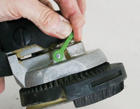

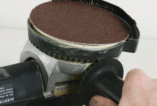

Although the RAS 115.04 E resembles a random-orbit sander, its motion is strictly circular. According to Festool, the machine gets its power - enough to remove multiple layers of paint and varnish - from a low-speed high-torque motor, which spins a compact 4 1/2-inch sanding disc.
Hassle-free setup. After fiddling with an assortment of wrenches and screws to fine-tune the cut on the other power scrapers, it was a relief to simply slap on a disc and get to work. Not that I didn't have to make any adjustments. This tool has a variable-speed dial, inscribed with settings from 1 to 6. For paint removal, the manual recommends setting the speed control somewhere between 3 and 6. With practice I found that slower was better, and so I usually kept the speed at 3 or less.
Operation. Sandpaper grits for this tool range from 24 to 80. Outfitted with a fresh 36-grit disk, the Festool chewed through thin coats of latex paint faster and smoother than the Metabo. Performance dropped significantly, however, once the paper began to gum up, which tended to happen within 10 or 15 minutes. (The 24-grit paper did not gum up as quickly but it was less effective at stripping the paint.) And when it took on thick, alligatored oil paint, the Festool could not keep up with the competition - regardless of the condition or texture of the sandpaper.
Dust control. Instead of extracting dust through holes in the sandpaper (there aren't any), the tool draws debris into a gap between the edge of the sanding disk and the surrounding "extractor hood." The hood is fitted with a moveable brush that you adjust by rotating the auxiliary handle. To maximize the amount of dust captured, the manual instructs the user to "turn the brush ring into the direction of travel of the sanding disk." I often had to fiddle with the brush to determine its most effective placement, but once it was dialed in, it really cleared the air.
Shortcomings. The extractor hood is secured by a quick-release lever. While this lever makes for easy removal, it's also easy to bump, which can knock the whole tool out of alignment and damage the bristles on the brush ring. (Actually, the brushes seem to wear out quickly even when the alignment is spot-on. I was glad I had extras on hand when I needed them.)
There are definitely advantages to using a sander to remove paint: You don't have to worry if you strike an unseen nail head, and there's much less chance of marring the surface of the work. On the other hand, you'll almost certainly spend more money for sandpaper than you would for blades - a 25-pack of 4 1/2-inch Festool discs can cost as much as $20.

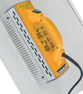

Speedheater IR 1100-15
Using heat to strip paint is a tried-and-true technique but it's lost favor in recent years. One problem is that it presents a fire hazard; another is that high-temperature heating devices - those that operate above 700°F - can turn lead into toxic gas.
According to its maker, the Speedheater uses infrared radiation to break the bond between the substrate and the innermost layer of paint. The company says the paint never exceeds a temperature of 400°F (well below the point at which lead vaporizes).
Based on previous experience I knew that the scrapers are almost as important as the paint remover, so for this review I requested a kit that included a clapboard scraper and a profile scraper.
Heat, scrape, repeat. As with the other paint removers, testing the Speedheater required a bit of trial and error. In this case it was somewhat like making an omelet. I'd place the tool on top of the doomed paint surface for about 20 seconds. When the paint began to bubble, I'd remove the heater and start to scrape. If my timing was just right, the paint would peel up in a sheet. If I was too soon, I'd have to reheat the surface for a few more seconds; but if I'd waited too long, the paint would come off in a gloppy mess. With practice I got it right more often than not.
Pluses and minuses. With the Speedheater in one hand and a scraper in the other, a skilled operator can strip paint in one continuous motion - or so I've been told. I never achieved that level of proficiency. For me, this tool was the slowest performer of the group when it came to removing thin paint layers (until the Festool sandpaper gummed up). But when the going got thick, the Speedheater left the competition in the lurch. Thick, heavily alligatored oil paint caused the mechanical paint removers to bog down like cheap snowblowers in heavy snow, while the Speedheater plowed through with ease.
I also appreciated this paint remover's versatility. The multisided profile scraper included in the kit made it easy to strip paint off moldings. The Speedheater was also the only tool I felt perfectly safe operating from an extension ladder.
