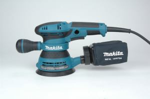

Makita BO5041K Random Orbital Sander
This lightweight tool is easy to hold and produces a very good finish.

One of the five models in our mixed category test of variable-speed rear-handle and right-angle 5-inch random orbit sanders; this tool is one of the three high-speed, fine-finishing models. And it’s among the newer generation of rear-handle sanders with a removable front handle. This lightweight tool is the most like a common palm-grip sander with its ability to be easily operated with one hand–either on top of the tool or wrapped around the tool down low with a body grip.

Finish quality was determined by feel and by eye. To show the scratch pattern created by the sander we made a single pass over clear acrylic (photo above) with 150 grit paper. The scratches left by this sander are barely discernible.

Lightweight, mild-mannered sander that is very easy to control and the tool with the greatest grip versatility.
The front handle can be locked in place at any point around the tool. Positioning it off the side as shown will increase your reach a little while securing it opposite the rear handle provides the most even distribution of downward force.
