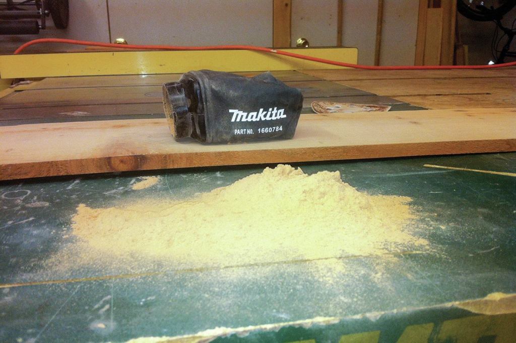

Though I’ve had the LXOB01 for only a few weeks, I’ve used it enough to say that it works surprisingly well. It’s slightly slower and about a half-pound heavier than comparable corded models (it’s based on the BO5031), but it feels very similar in use. When I put a 100-grit disk on the tool and sanded the face, sides, and edges of rough redwood fence boards, it removed the surface material quickly, and the convenience of not having a cord to deal with partially offset the additional weight.
According to Makita, the tool can sand for 20 minutes at high speed and 40 minutes at low speed on a 3.0-Ah battery. To find out if this was true, I installed a 100-grit disk and timed how long it took to deplete a fully charged battery while sanding redwood at high speed. The tool ran strong for 25 minutes, at which point the motor slowed and made it clear that the battery was just about empty.
When testing cordless tools, I’m in the habit of stopping every so often to let motors and batteries cool. This turned out to be unnecessary with the sander — the battery remained cool and the tool never became more than slightly warm. Evidently, sanding doesn’t strain motors and batteries the way drilling big holes or driving lags does.
