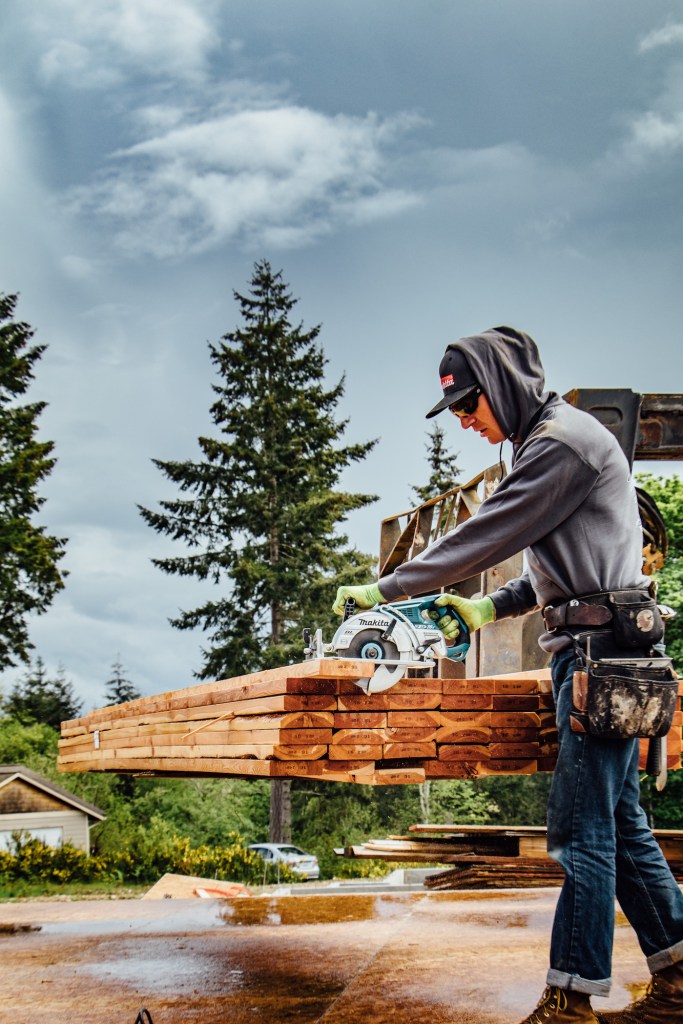

Pros of cordless on a wet site. According to Makita, its “Extreme Protection Technology (XPT)” improves dust and water resistance in harsh conditions by channeling water and dust away from the internal components. It seems to be working; using this tool in a way-above-average wet spring didn’t present any difficulties. And no cord means no tripped power.
Tim Uhler Pros of cordless on a wet site. According to Makita, its “Extreme Protection Technology (XPT)” improves dust and water resistance in harsh conditions by channeling water and dust away from the internal components. It seems to be working; using this tool in a way-above-average wet spring didn’t present any difficulties. And no cord means no tripped power.
