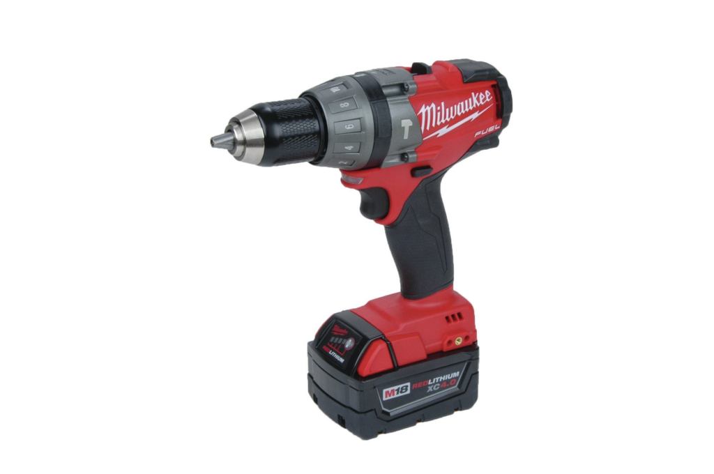

Here’s a quick look at the specs, features, pros, and cons of the Milwaukee FUEL 2604-22 hammer drill/driver. This information was excerpted from a tool test in the Spring 2015 issue of Tools of the Trade. The main story contains an overview plus runtime and power test data for all tools tested.
Battery: 18 volts; 4.0 Ah
Battery gauge: 4 bars; on battery
Weight (pounds): 5.15; with handle 5.68
Rpm: 0-550; 0-1,850
Hammer Bpm: 0-9,350; 0-31,450
Other Features: Brushless motor; LED headlight; 9 7/8-inch side handle
Price: Kit $299; bare tool $149
Includes: Tool; 2 batteries; charger; plastic case
Country of origin: Tool China; battery Korea and China
Performance: Rated very good under heavy duty uses and a top-tier performer overall. Third in runtime. (See comparison tables in Main Story)
Comments: A rock-solid brushless motor tool—with a traditional design and features—that works as you expect without any learning curve.
Pro: Side handle attaches to tool without having to slide over bit and chuck.
Con: No belt hook, but has mounts for optional accessory hook on both sides of tool.
