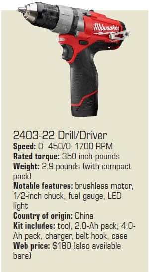

I received a kit version of the drill/driver (2403-22) that included a charger, a case, and two different batteries—one 2.0-Ah compact pack and one 4.0-Ah XC pack.

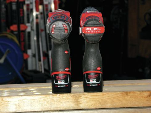

The first thing I noticed about the tool was that the handle was much more comfortable to grip. The old handle was about the same diameter all the way up and always felt fat, whereas the new handle tapers in above the battery where your thumb wraps. It’s an improvement that has been incorporated into all of the M12 FUEL drilling and driving tools.
Another big change is the chuck—the old one was 3/8 inch; the new one is 1/2 inch. You wouldn’t think that it would make much of a difference, but it does. Now, when I need to run 1/2-inch shank bits, I can stick with a small, light tool and not have to go to an 18-volt model. Like the chuck on the previous M12 drill, this one ratchets, is all metal, and has a single sleeve.

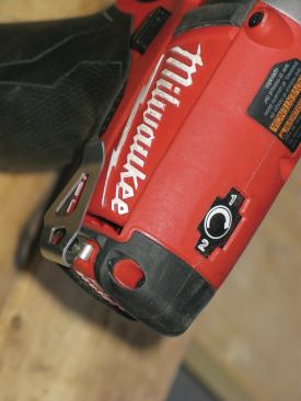

The addition of a small belt clip to the drill/driver (and other M12 tools) is a welcome improvement. It’s good for hanging the tool from a belt or pocket; it was a little tight, but I bent it open and it fit on the pocket of my tool belt. Something that didn’t change is the handy battery gauge built into the side of the drill.

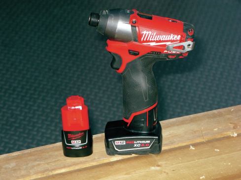

I received a kit version of the impact driver (2453-22), which included a charger, a case, and two 2.0-Ah compact packs.
Improvements over the previous, brushed model include a more comfortable grip (tapered at the top like the drill/driver’s), a belt clip, and a higher maximum speed. The previous M12 impact driver topped out at 2,000 rpm; this one tops out at 2,650 rpm. A mode switch allows the operator to reduce maximum speed to 1,200 rpm for greater control during delicate operations. It’s akin to changing from high to low on a drill/driver, but instead of relying on gears, it relies on electronic control of the motor.
