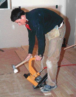

I’m a small custom home builder and remodeler in northern Vermont. I install enough strip flooring every year that I found it necessary to buy a Bostitch flooring stapler seven years ago. The tool has always been dependable, so I wasn’t really in the market for a flooring nailer, but when JLC asked me to test five pneumatic flooring nailers on a recent job, I thought it would be interesting to compare. My helper, Kyle Darling, and I laid around 2,200 square feet of 3/4-inch oak and ash flooring using the five guns and kept notes on how the guns performed.
We looked for the same features in these nailers that you would look for in any pneumatic nailer: power, ease of use, ease of loading, weight, and balance. Because flooring nailers are specialized, we also looked for features that might make one gun more useful than another, when nailing close to a wall, for instance.
Pneumatic floor nailers, from back to front: Porter-Cable FCN200, Bostitch MIIIFN, Senco SHF50, Powernailer 445, Portamatic Hammerhead 2 (set up for face nailing).
Bostitch MIIIFN
This tool was very familiar to me — it’s essentially the same tool as my stapler, only set up for floor cleats. Like other Bostitch tools I’ve used over the years, this one is ruggedly built. It was easy to load and had plenty of power. It took only a light strike with the mallet to actuate the driving pin, which enabled us to nail fairly close to a wall, where there wasn’t room for a full mallet swing. However, with a more energetic swing, the nailer had the power to drive the flooring tight.
Bostitch MIIIFN
The nailer was well balanced and easy to grip and position on the flooring. At first, the gun would hang up on the tongue when we set it in place, but we found that a thin cardboard shim placed under the plastic shoe took care of that. (This may well have had to do with the milling of the particular lot of flooring we were working with.) The gun was not excessively heavy or loud. Unlike the other tools we tested, this one has no safety to prevent misfires. Of course, the nature of flooring installation means that the gun is always pointed down; plus, it takes a hammer strike to actuate the driver. So we never missed the safety.
